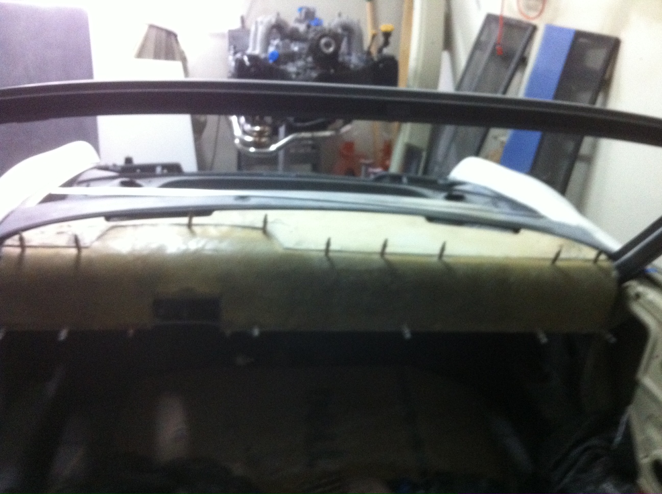

so, I did it. I cut apart my dash last night and laid some glass. Here is the rough mold. Still have to finish the sides and tie it all together. The rest of the dash will be modular so pieces can be taken off.
Time to start building a glove box... form space for headlights, gauges and instrument cluster

effutuo101   so, I did it. I cut apart my dash last night and l...   Mar 27 2012, 12:08 PM
