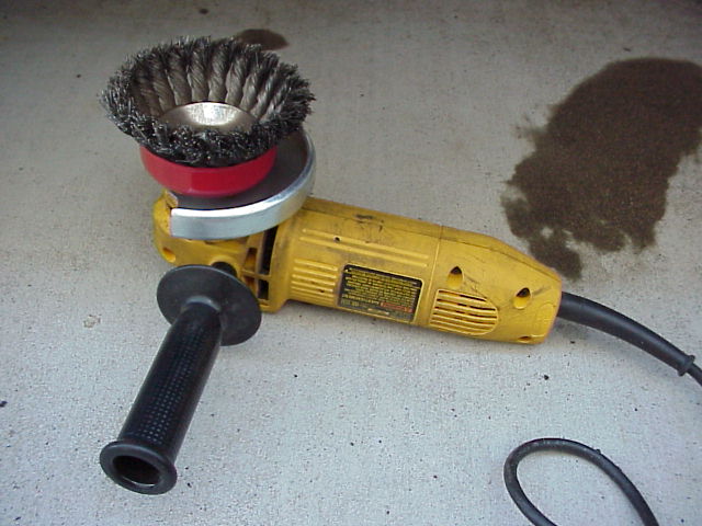

Damn I love tools. The right tool makes all the difference. I was chipping away at undercoating, paint and rust with a putty knife. I went to the unmolested donor car and realized that I was hacking away at seam sealer. I remembered a Pelican post where the guy used a large wire cup brush. Quick trip to Ace. Worked like a champ.

Gint   Took the crap right off.   Apr 18 2003, 08:50 PM
