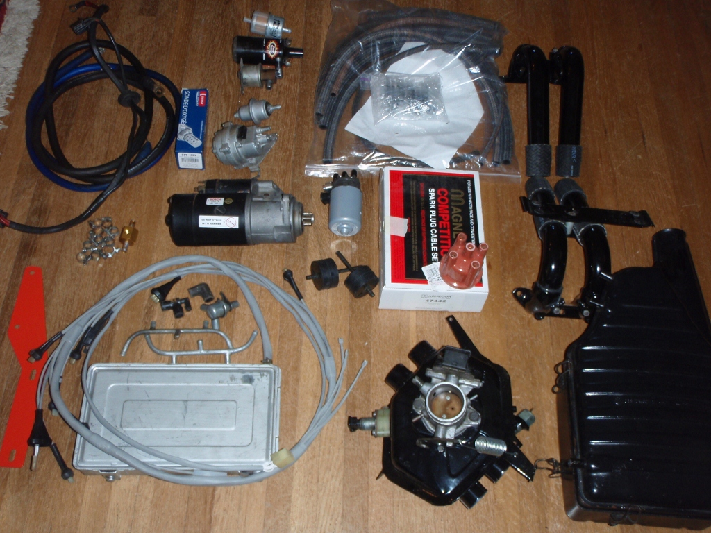

I should have the engine back this weekend from Tony @ Translog GT. Once I pick it up, I just need to dress it with my D-jet. I pulled everything out of the box to make sure I didnt lose anything (IMG:style_emoticons/default/rolleyes.gif) I did. Cant find that damn head temp sensor, no worries cause Tony has one for me. (IMG:style_emoticons/default/smile.gif) I purchased the resistor to richen up the mix so I could at least break in the engine. Then I may need help with adjusting the MPS, not sure yet. I do have an 02 sensor and I will be able to tell if its close.
Here is my stash as it came from hibernation
