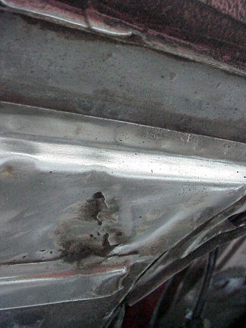

Gint   Near the left rear donut.   Apr 18 2003, 08:52 PM
