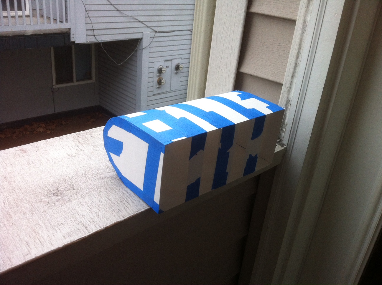

effutuo101   on a con call since 5 am. So, I built and test fit...   Mar 30 2012, 03:00 PM
effutuo101   an now for a picture... pre wax and final prep for...   Mar 30 2012, 03:01 PM
effutuo101   yes, it is a mail box...:) but once I get the glas...   Mar 30 2012, 03:02 PM

effutuo101   So, late last night, I popped the glove box off th...   Apr 1 2012, 08:14 AM
effutuo101   a little trimming up and presto, a glove box. @ ...   Apr 1 2012, 08:16 AM
