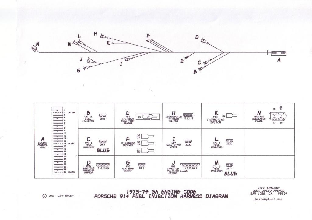

When I fired it up,it ran like crap! Wouldn't idle and just sounded like garbage. New plugs and wires,new fuel lines,filters and vacuum lines. So I started checking all connection and bingo! Broken wire on the CSV harness ,had been repaired before. Only issue,when I pulled off the electric tape the connectors dropped out of the plastic plug holder. So,does it matter which wire goes where? If so,how do you know....both wires in the harness are white. (IMG:style_emoticons/default/confused24.gif) SW |

Found it! BOWLSBY......YOU ROCK.
Your GA Harness diagram was perfect for what I needed. Thanks JEFF (IMG:style_emoticons/default/pray.gif) (IMG:style_emoticons/default/pray.gif) SW |
