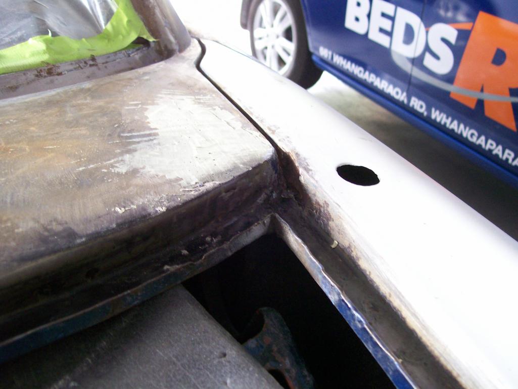

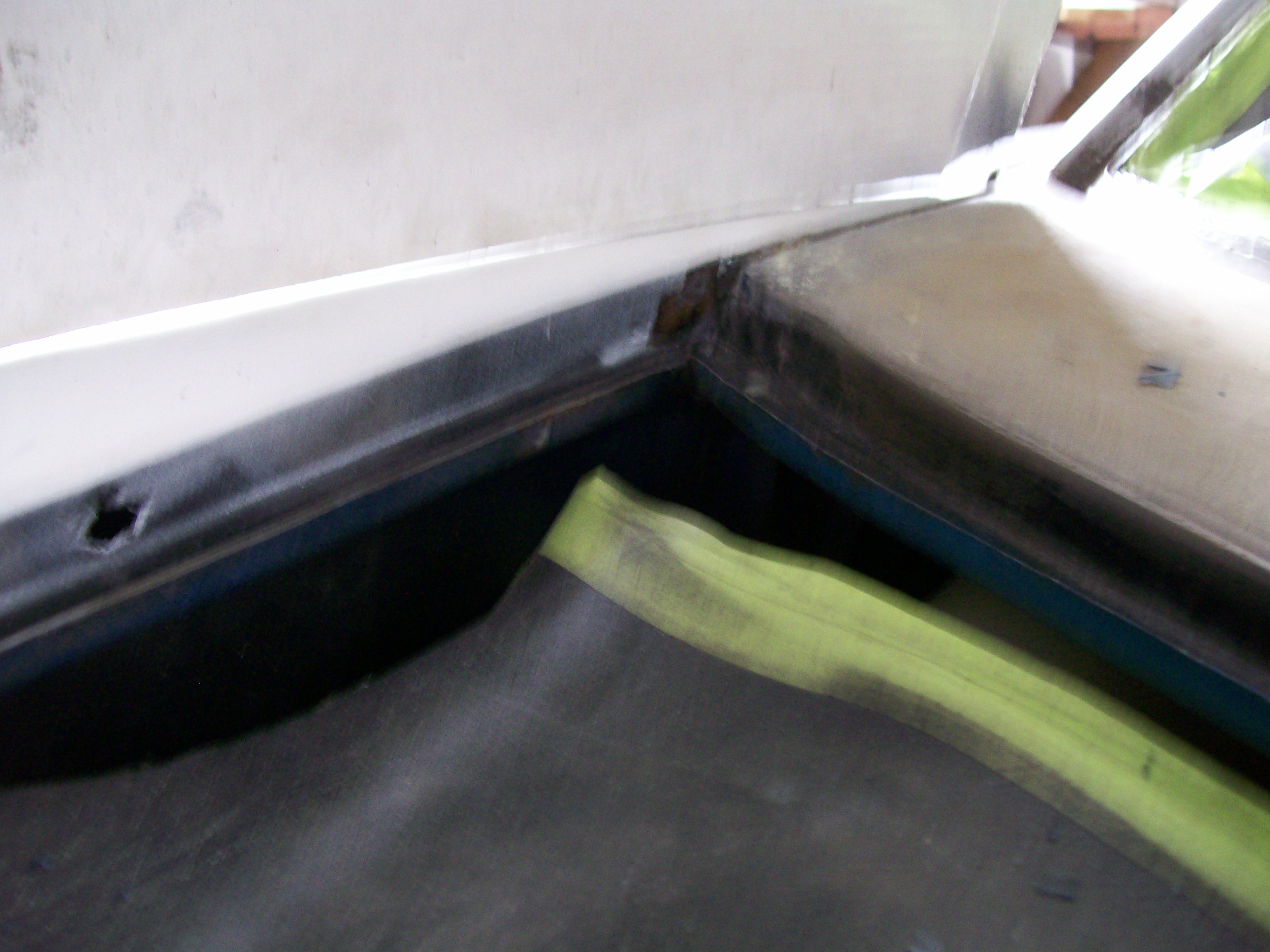

Attached ImageAttached ImageSorry, these aren't great shots. On the RHS there is a hole that is pretty clear. I don't see a problem with this one welding a small patch. It's the holes further back on both sides that concern me. I can't see how you would get a weld down inside the join.
Hopefull the pics will work.

rick 918-S   Post photos so we can see what your up against. :t...   Mar 30 2012, 02:02 PM
Tom_T   Post photos so we can see what your up against. :...   Mar 30 2012, 02:14 PM
rick 918-S   Post photos so we can see what your up against. ...   Mar 30 2012, 08:47 PM

rick 918-S   Very poor photos but I think I get what your doing...   Mar 31 2012, 09:24 PM
porschefile2010   Thanks Rick. I will take a look at the problem fro...   Mar 31 2012, 10:16 PM
