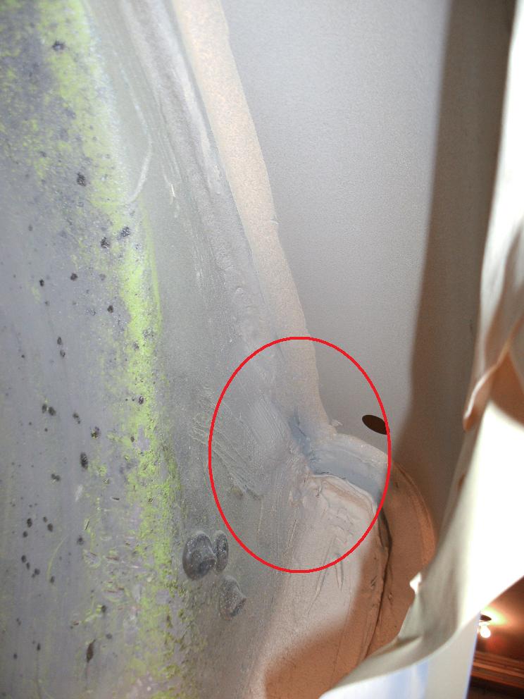

Very poor photos but I think I get what your doing. If the gaurd is the panel with the hole take a butane torch and warm the seam sealer on the inside of the gaurd you will find it is packed with seam sealer. Here's a photo of the area. I just re sealed this gaurd. You can then clean this up real good with a wire brush and cut the rust out make your patch and weld it from inside the wheel well. Hope this suggestion helps.
I'm not sure you saw this thread from a couple days ago but maybe it will help. http://www.914world.com/bbs2/index.php?showtopic=177500

porschefile2010   Sorry, these aren't great shots. On the RHS t...   Mar 30 2012, 10:02 PM

rick 918-S   Very poor photos but I think I get what your doing...   Mar 31 2012, 09:24 PM
porschefile2010   Thanks Rick. I will take a look at the problem fro...   Mar 31 2012, 10:16 PM
