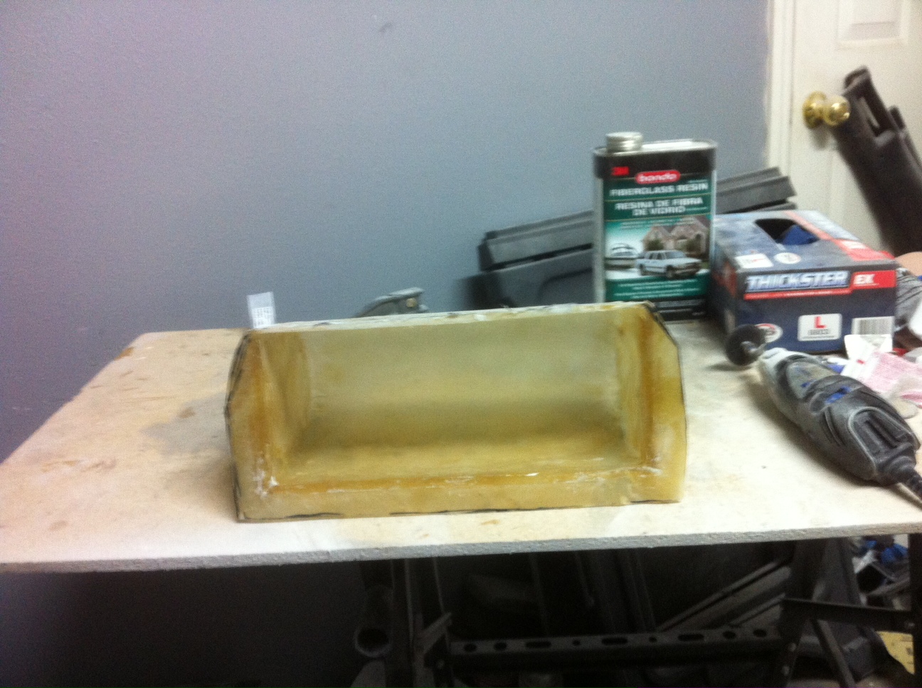

So, late last night, I popped the glove box off the mold and trimmed the excess off.

effutuo101   So, late last night, I popped the glove box off th...   Apr 1 2012, 08:14 AM
effutuo101   a little trimming up and presto, a glove box. @ ...   Apr 1 2012, 08:16 AM
