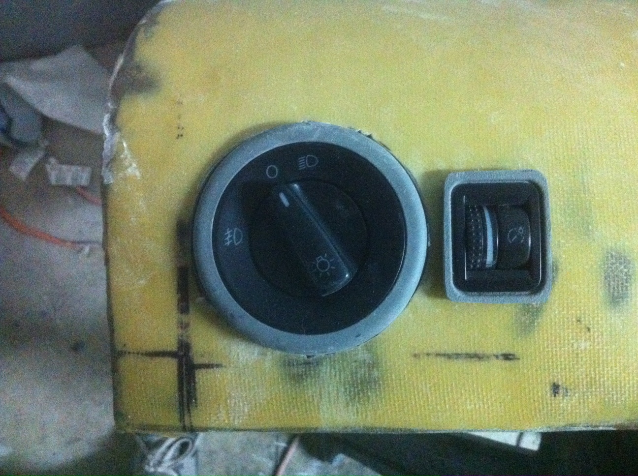

got the headlight switch and dimmer switch cut out and fitted.
