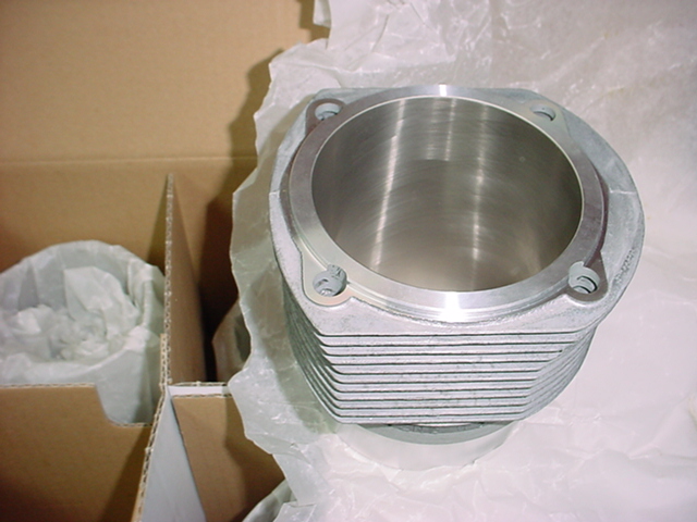

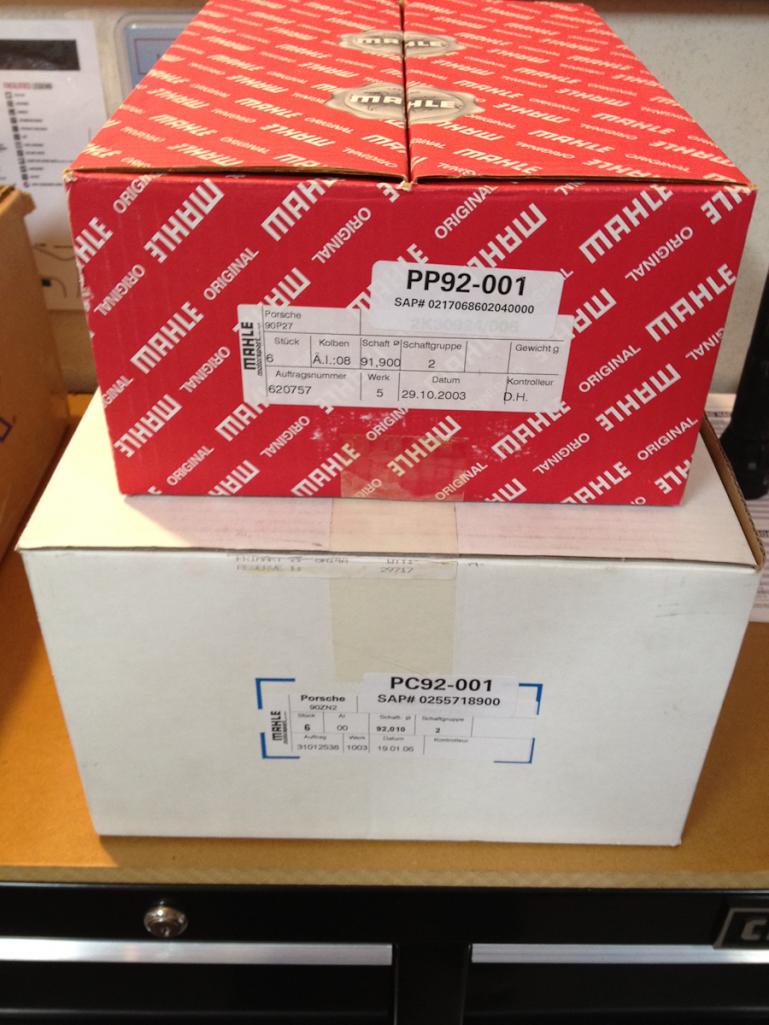

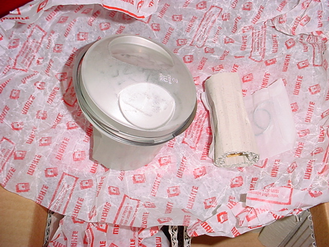

Finally! After months of frustration I finally have my hands on the 92mm (2.8) P&C's to put my engine back together. Apparently Mahle only makes the less common stuff in batches every once in a while and once they're gone you are SOL until they decide to make more. They weren't planning to make any more 92mm stuff until this summer at the soonest.
I probably will not use these pistons as they're "only" 10.5:1 C/R and I want to go up to 12.5:1 or so ideally; getting pistons should not be a problem as it's the barrels that are made of unobtainium. I will probably save these pistons in case someday I want to put the car back to a more streetable configuration.

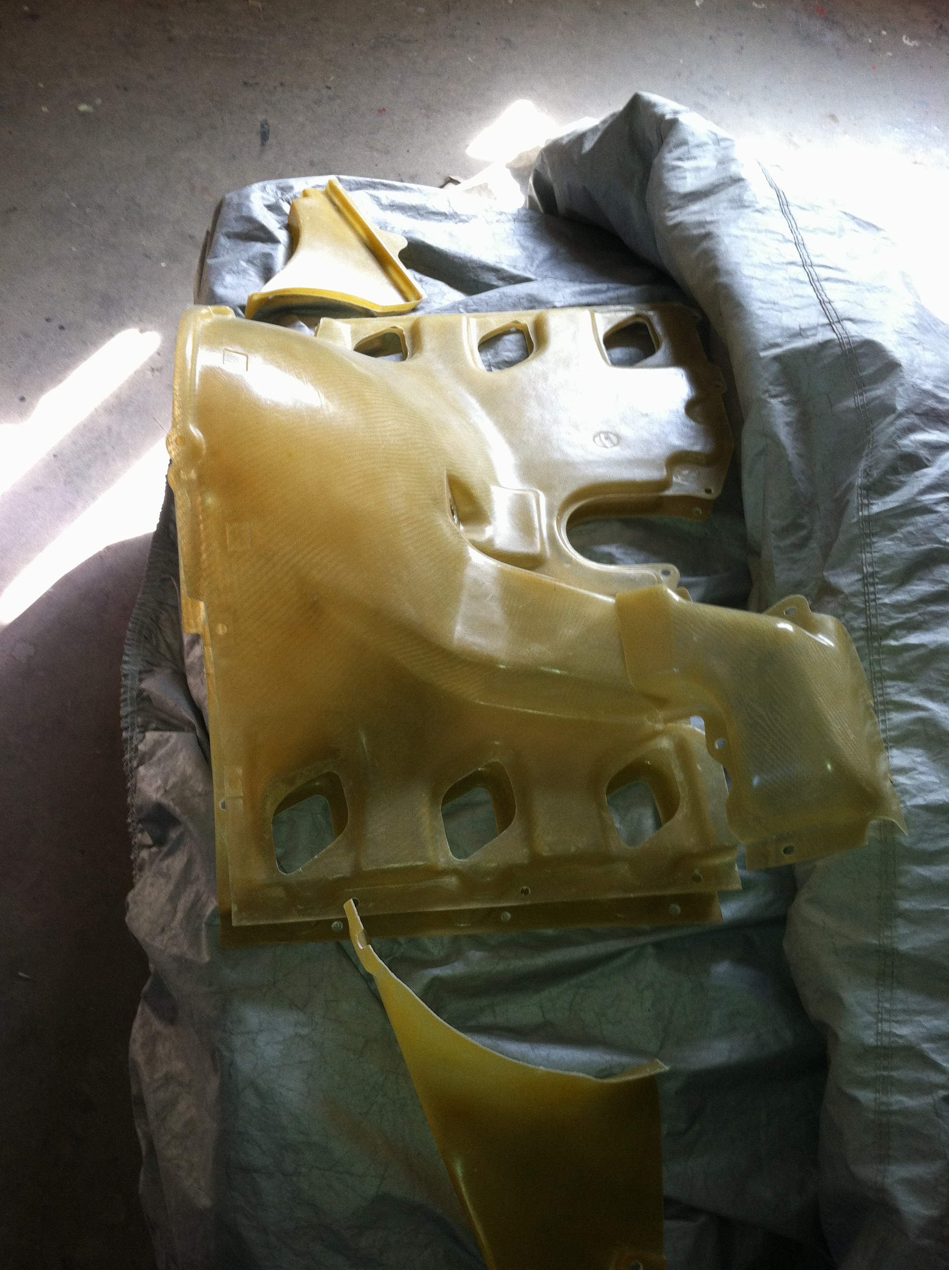

I also have one of these on the way. It's not an absolute necessity but is cool, and my current "S" red shroud is a bit damaged.
There are still some kinks with the bodywork to figure-out as well. The rear flares are too small to fit the optimal tires and the fronts have some strange geometry/clearance problem I don't fully understand yet (going to see in person this week). The solution to that may be going back down to 15" wheels/tires which would require re-modifying or changing the struts.
