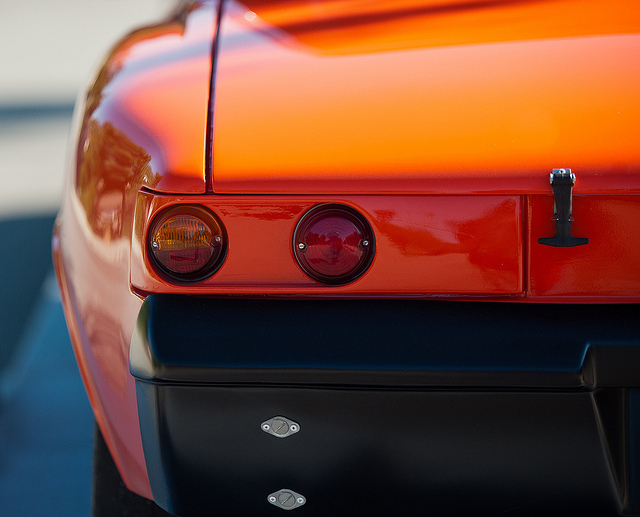

campbellcj   I could have used more clearance in back as it tur...   Oct 22 2011, 11:47 AM
Racing916   Car looks great where did you get the front splitt...   Oct 22 2011, 12:41 PM
campbellcj   Car looks great where did you get the front split...   Oct 22 2011, 01:58 PM
