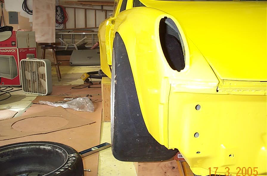

Been down the weird front geometry/clearance road. Your front fenders now give you enough room to screw you into the ground....the quickest way to get there is by using spacers. Just because some tire wheel combo will fit doesn't mean it should be there. Case in point....see pic. Ayup, got em in there and made sure they cleared at full compression, lock, & droop. Made for a lost season of steering effort like a dump
truck and understeer.

J P Stein   Been down the weird front geometry/clearance road...   Apr 1 2012, 12:38 PM

J P Stein   The sad fact is that we must base our decisions on...   Apr 2 2012, 09:22 AM

J P Stein   The slicks in my pics.(ah, poetry) are 10 X 22.5 X...   Apr 2 2012, 12:31 PM
