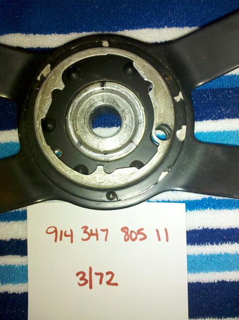

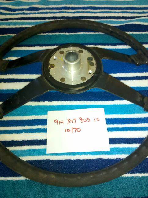

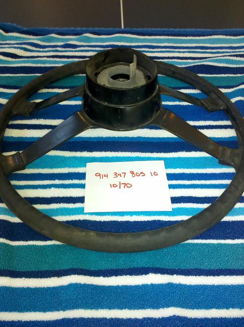

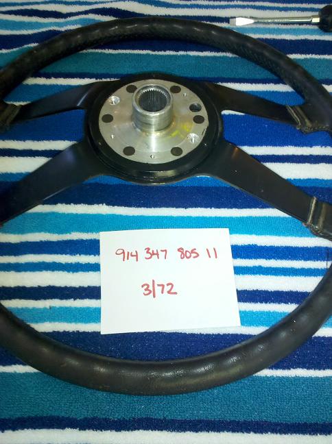

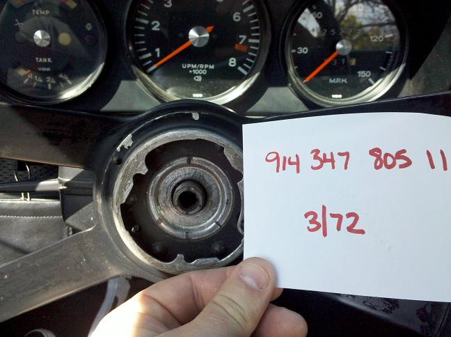

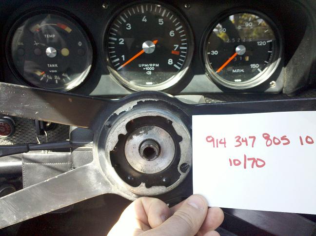

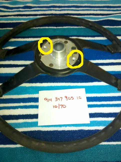

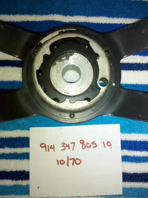

I am going to have to agree with Lightweight on this one. I had just picked up a wheel from pick and pull this week. My thought is that I would use it on my car while I sent another one out to Dallas Custom Steering Wheels for the double leather (Extra thick grip)wrap. This thread had me worried for a minute.
Car is an 1970 original 914/6.
Here is my investigation from this morning:
Note the recess center.
With the hub unscrewed. One minute process.
On the /6
On the /6
The early wheels have the countersink for the 914/6 turn signal cancel ring.
Hope this helps. (IMG:style_emoticons/default/blink.gif)
