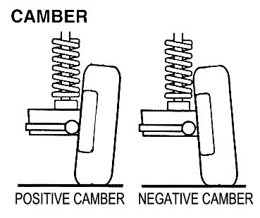

I installed a small 6 in my car yesterday and I noticed the car has more positive camber to the rear wheels than before the conversion. Is there an adjustment for camber? Ive yet to put on the axels, might that straighten it out?

rick 918-S   Check Chris Foley's site. He has Camber adjust...   Apr 1 2012, 08:08 PM
Jeffs9146   You remove shims to create negitive camber.   Apr 1 2012, 09:10 PM
Dave_Darling   Just the axles won't affect the camber. Putti...   Apr 1 2012, 09:28 PM
kconway   Just the axles won't affect the camber. Putt...   Apr 1 2012, 09:35 PM
Aaron Cox   Just the axles won't affect the camber. Put...   Apr 1 2012, 09:38 PM
SirAndy   Just to be clear, if the top of the tire tips in; ...   Apr 1 2012, 10:05 PM

kconway   Great info, much appreciated! Last thing, sh...   Apr 2 2012, 06:53 AM
SirAndy   Last thing, should the car be set up neutral or bi...   Apr 2 2012, 12:25 PM
RobW   It depends. If you are driving for street and long...   Apr 2 2012, 07:00 AM
