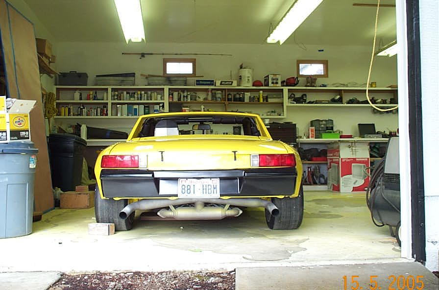

J P Stein   The slicks in my pics.(ah, poetry) are 10 X 22.5 X...   Apr 2 2012, 12:31 PM
