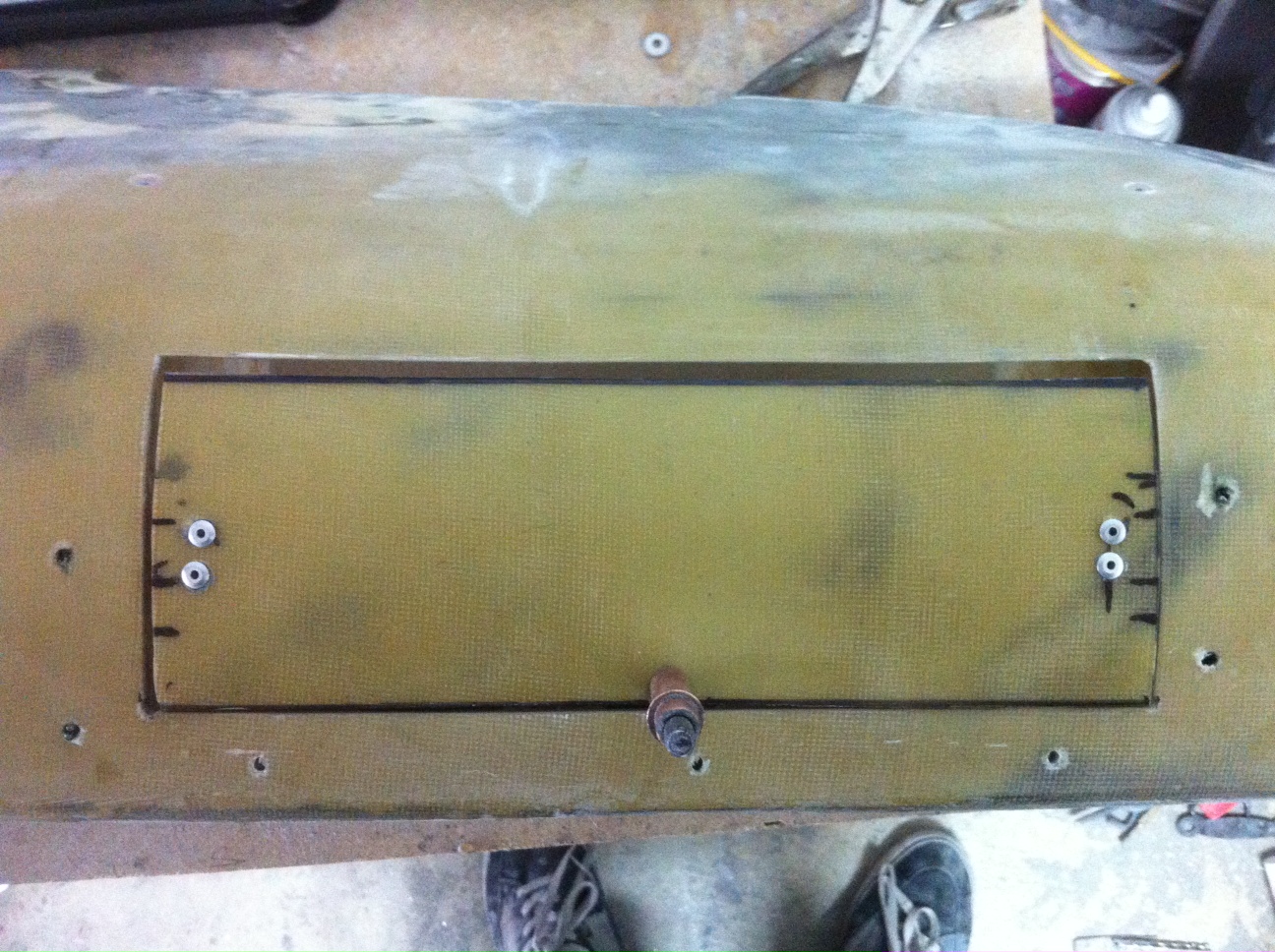

an oddly strange day at work. Took my lunch hour and did some work.
I got the glove box roughed in. left needs to come out about 2-3mm. Then straighten the edges of the box and loose some mass. This spot had a problem in my casting...
Then final fit, hinges, smooth it out, and put some felt in it.
just enough room for two pair of sunglasses, a small package of tissue, and registration/insurance stuff.
In the end it is about 7 inches deep. no where near the cavern that was stock, but, it also doesn't hang down below the dash.

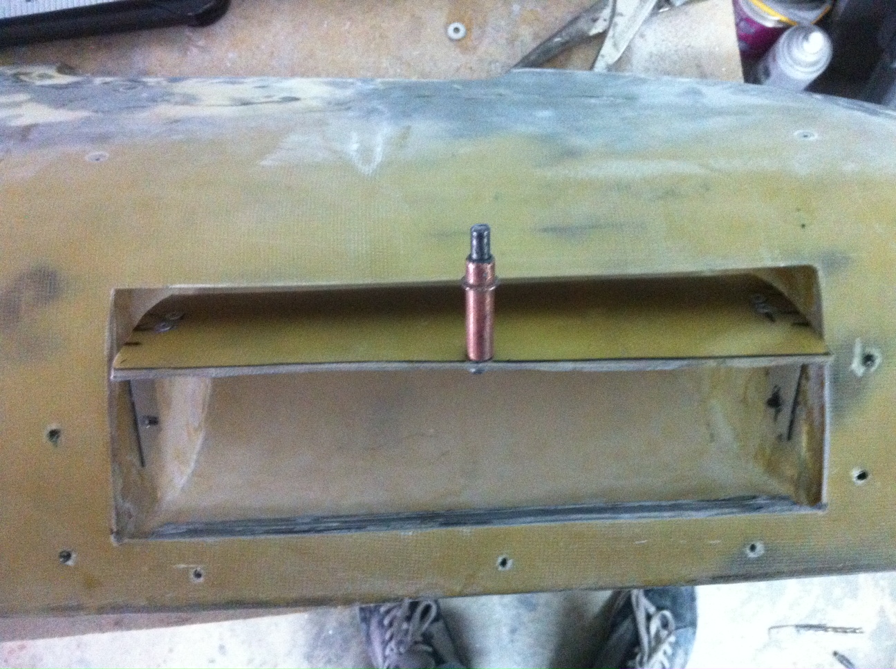

effutuo101   So, late last night, I popped the glove box off th...   Apr 1 2012, 08:14 AM
effutuo101   a little trimming up and presto, a glove box. @ ...   Apr 1 2012, 08:16 AM
