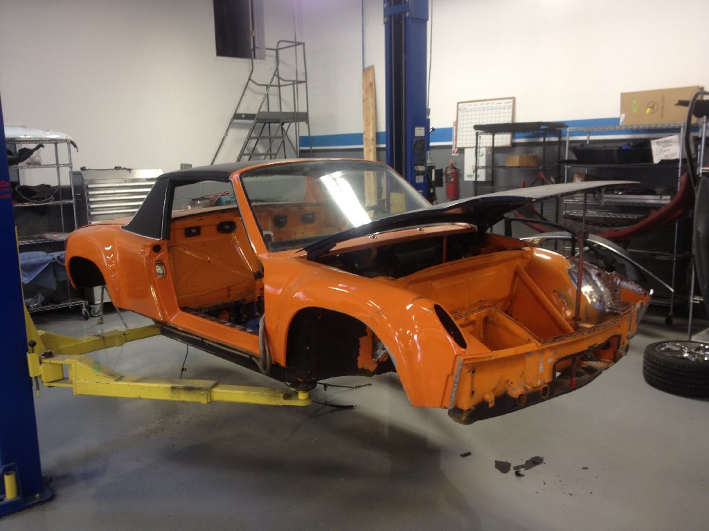

More progress photos.
And last call looking for a really nice front left fender, otherwise we'll use the one we have (which needs a bit of work itself).
We did get an OEM front left flare to match the others - the only corner that we could find anywhere. I guess I was "lucky" to scrunch that corner.
-Steve
