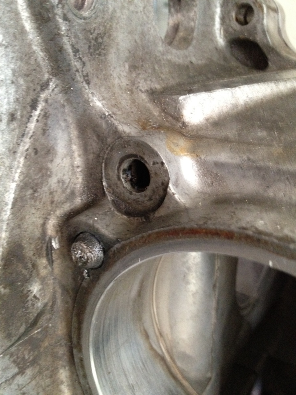

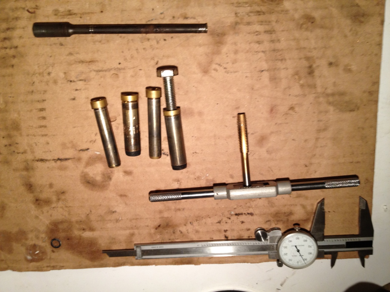

My nice clean block!!
With one small SNAFU
Luckily I found a use for the other half of the broken stud! A rudimentary old valve guide punch!

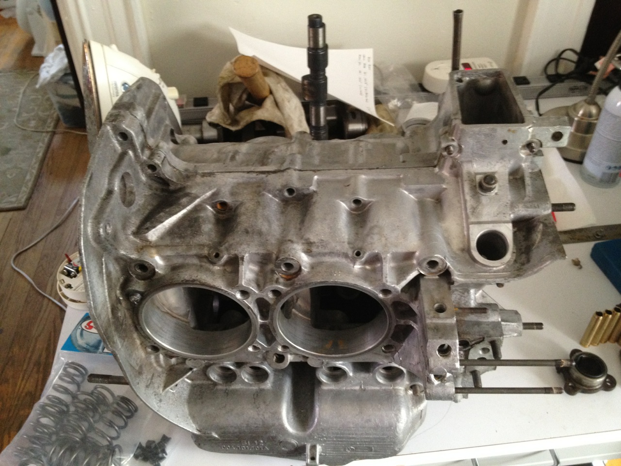

bohalrantipol   A couple of shots pre-itsbeensittingforalongtime t...   Apr 5 2012, 03:03 PM
