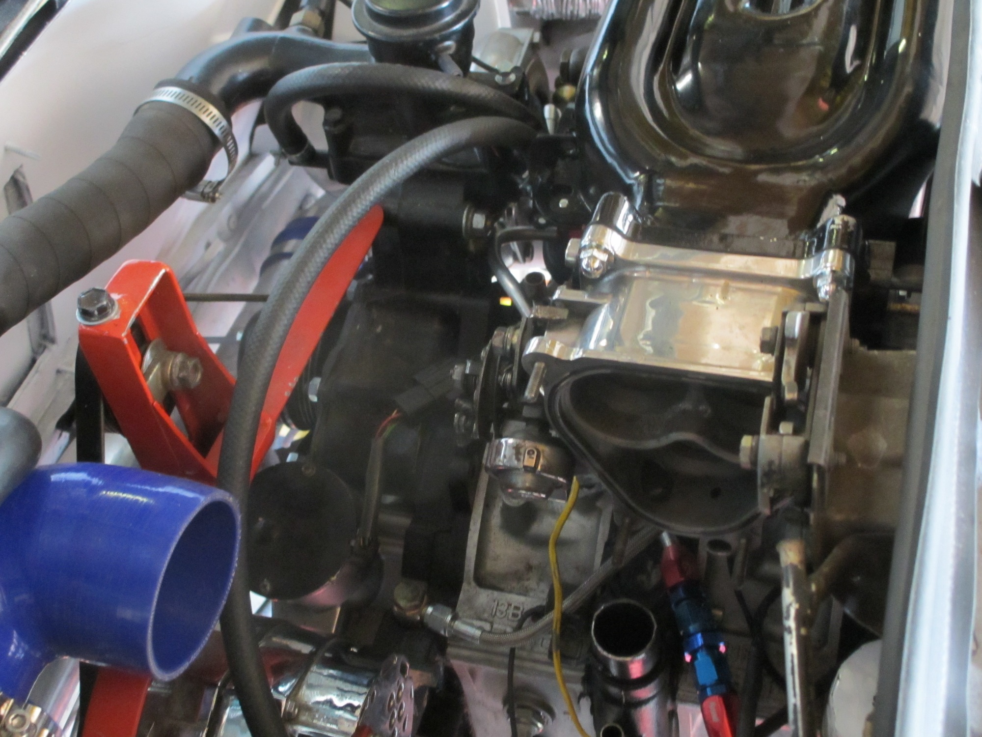

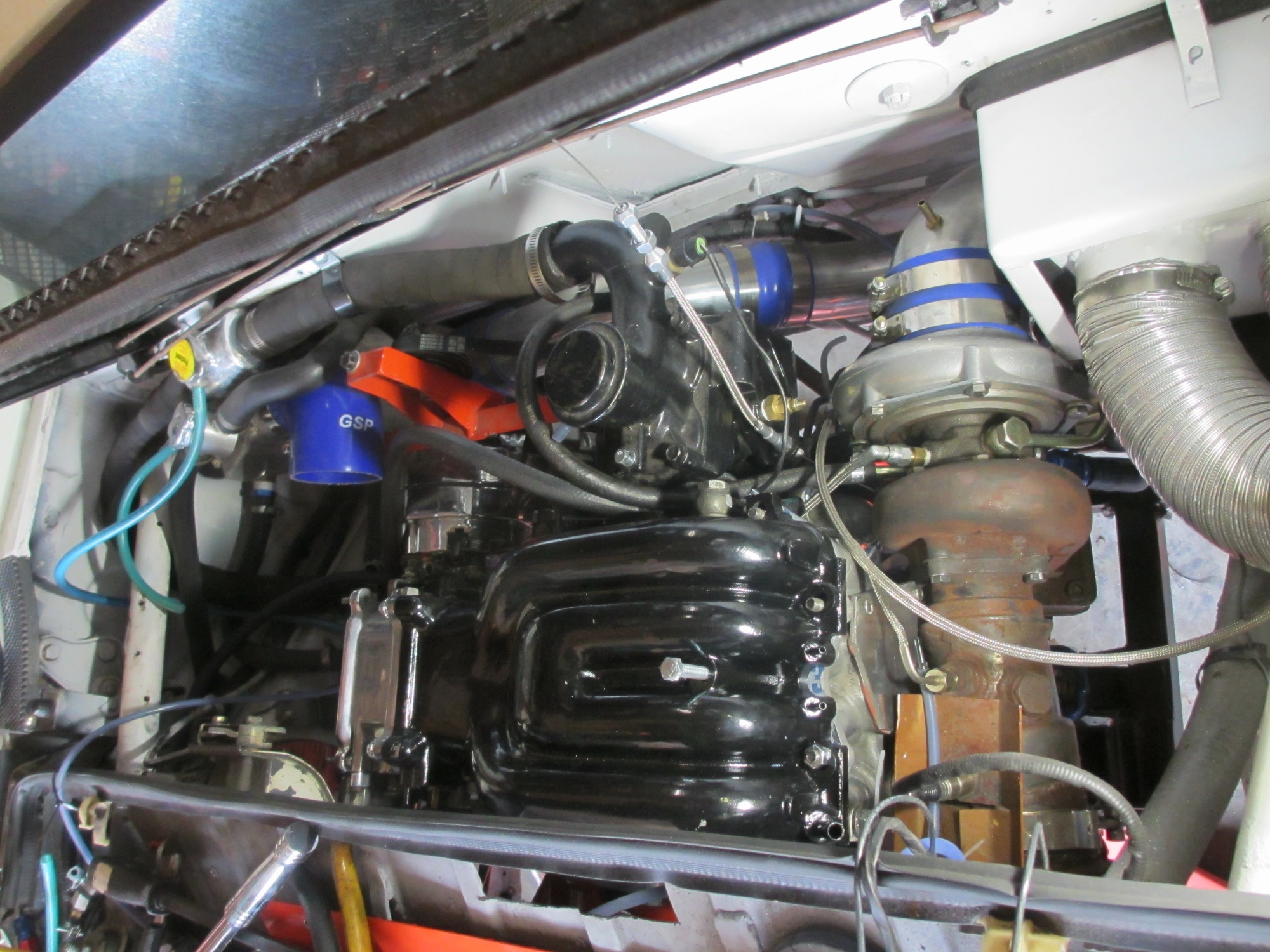

The new upper intake mocked into place. The new TB has a water connection for cold start. Hopefully, it warms up better, although it worked fine before without it. I am waiting for the TB snorkel to connect to the intercooler. Even without it, I can get it running and tuned without boost.
The oil filler tube needed modification. It hit the new TB. I have a plan to make it work but i'm waiting untill the final bolt down of the manifold.

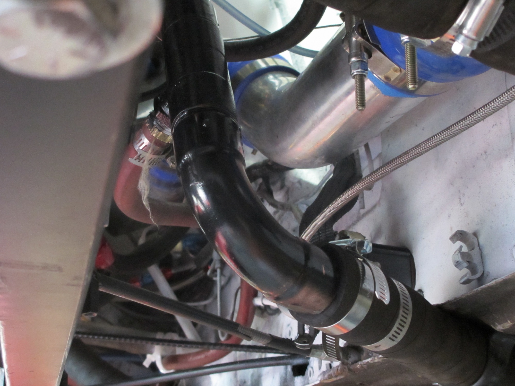

I had to replace the hose on the right. I got damaged while loading the car on the trailer. I changed the transition piece from threaded steel pipe to thick wall copper. I found 1.25" radius elbows. one 90* and one 45* with a T in the middle for the heater connection. This will connect the radiator return line into the water pump inlet. I'm not a big fan of copper but this seemed like a reasonable compromise and it flows better than the threaded piping. This is the only copper in the system.
