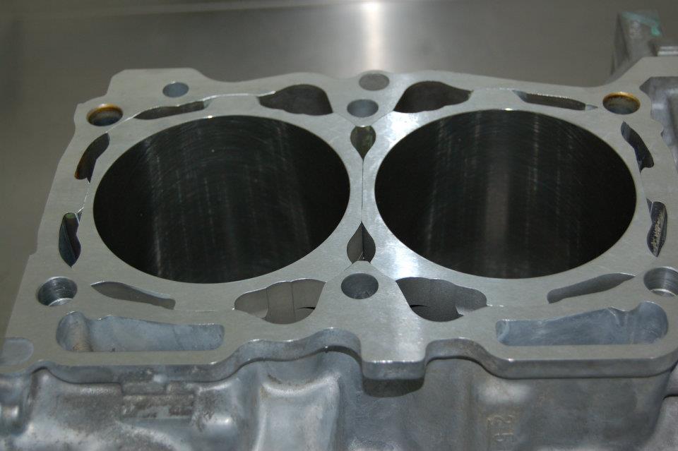

It's time to unleash the beast... Welcome the Nikisil bored JR28 in 103mm.
(IMG:http://www.914world.com/bbs2/uploads_offsite/fbcdn-sphotos-a.akamaihd.net-1095-1333910356.1.jpg)
We are also the sole US distributors for Subarugears reversed ring and pinion kits since you guys jumped on that topic.. Here are a couple of reversed trannys that are ready for their rear engine applications that we have in work now.
