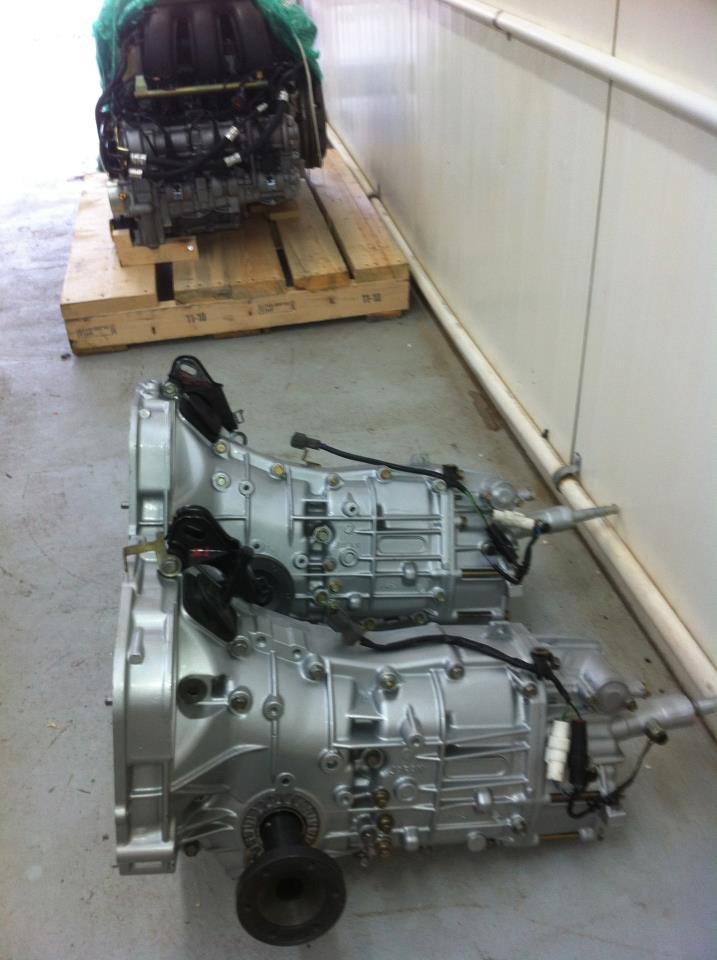

We are also the sole US distributors for Subarugears reversed ring and pinion kits since you guys jumped on that topic.. Here are a couple of reversed trannys that are ready for their rear engine applications that we have in work now.
(IMG:http://www.914world.com/bbs2/uploads_offsite/fbcdn-sphotos-a.akamaihd.net-1095-1333910357.2.jpg)
do you supply output flanges?

Jake Raby   It's time to unleash the beast... Welcome the ...   Apr 8 2012, 12:39 PM
nsyr   do you supply output flanges?   Apr 8 2012, 04:00 PM
Jake Raby   do you supply output flanges? Any 4WD 5 speed ...   Apr 8 2012, 04:08 PM
