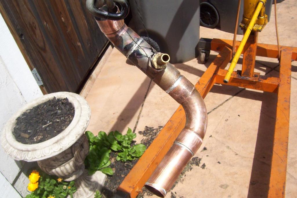

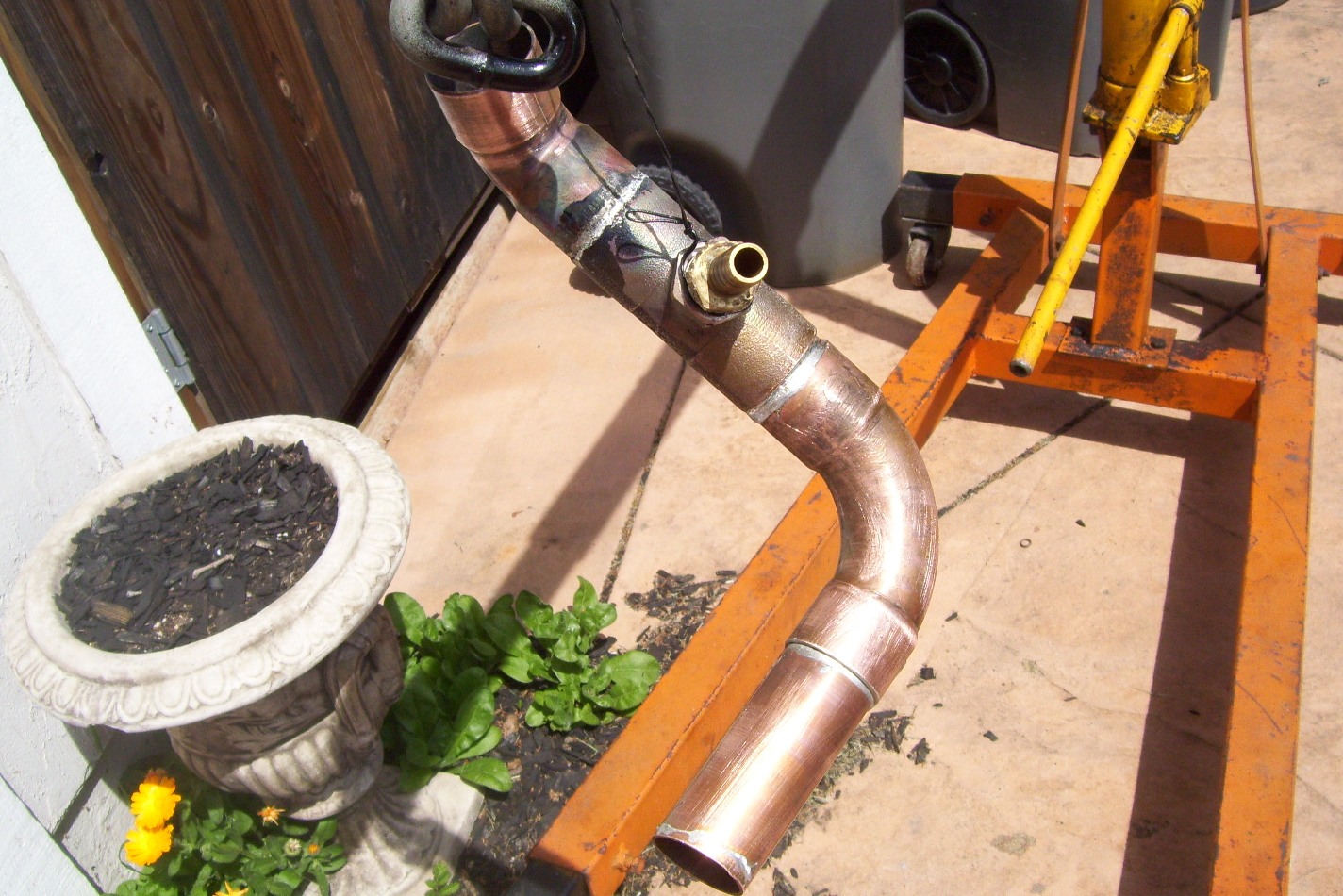

Here's a better pic of the copper transition piece I made. The T is brass with a threaded bung. The 1/2 nipple goes to the heater in the fresh air box.
