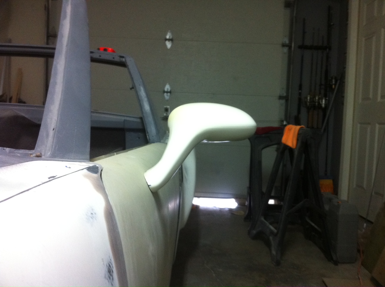

effutuo101   hood pins and mirrors showed up... I guess I will ...   Mar 23 2012, 05:59 PM
pete-stevers   where did you get those hood pins from??   Mar 23 2012, 08:12 PM
dakotaewing   What kind of mirrors?   Mar 23 2012, 09:13 PM
effutuo101   I got them bot from "dreamers" (local ho...   Mar 23 2012, 10:42 PM
effutuo101   The mirrors are Vision out of Canada. VF4 http://v...   Mar 24 2012, 09:18 AM
effutuo101   hood pins are Eddie Motorsports. they come in a te...   Mar 26 2012, 09:43 AM

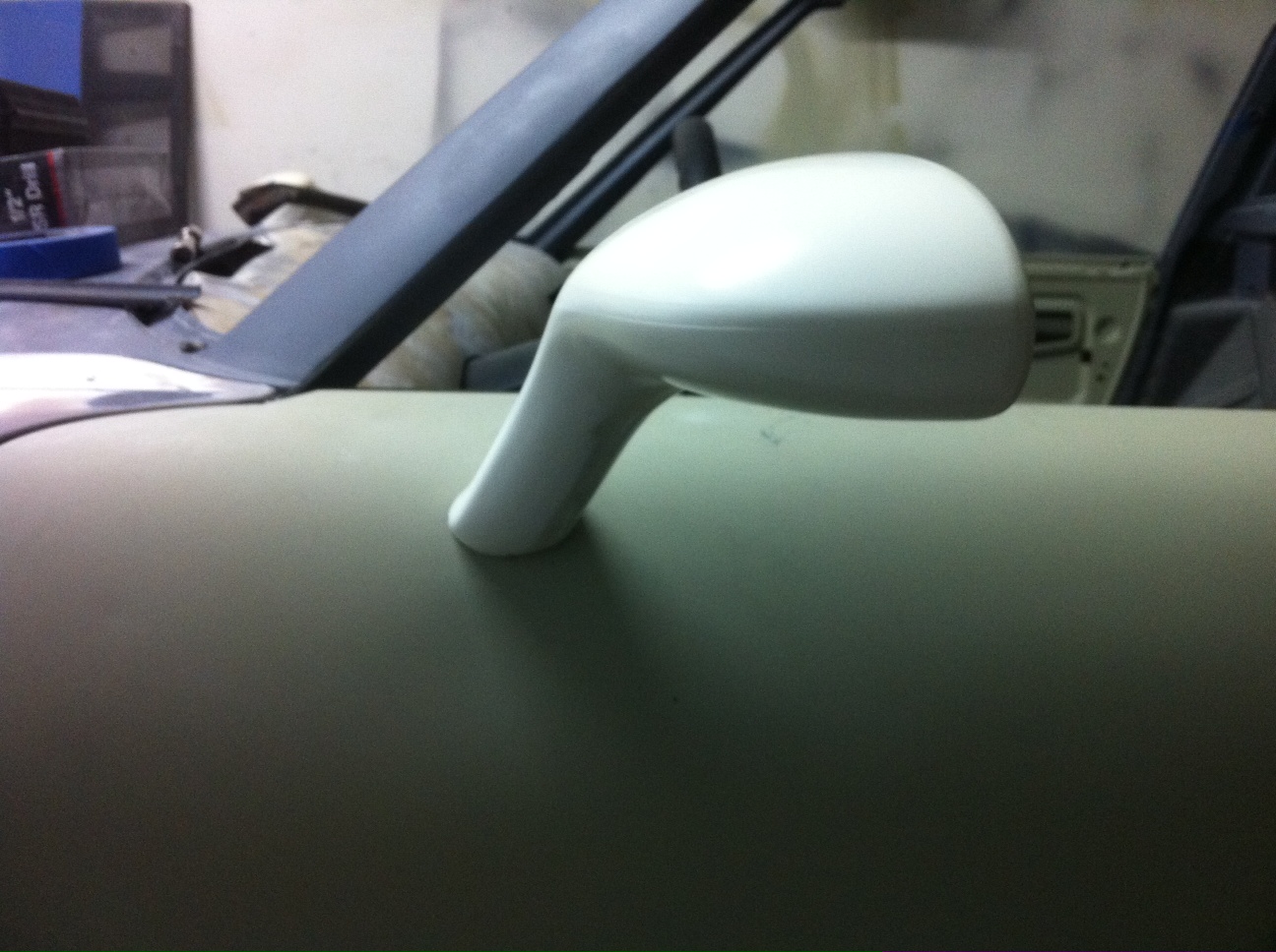

effutuo101   start mirrors   Apr 9 2012, 04:33 PM
effutuo101   lunch time work... :stir:   Apr 9 2012, 04:35 PM
