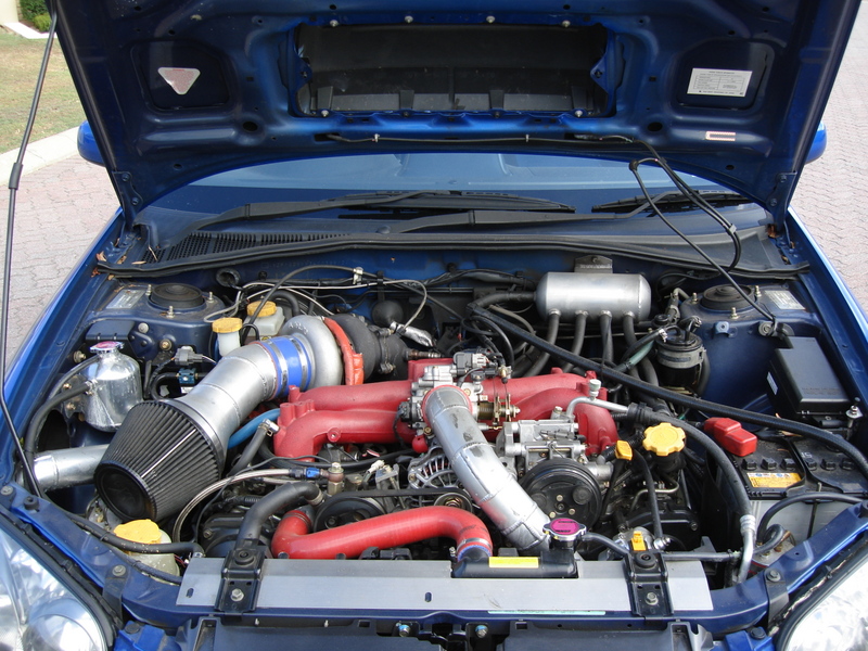

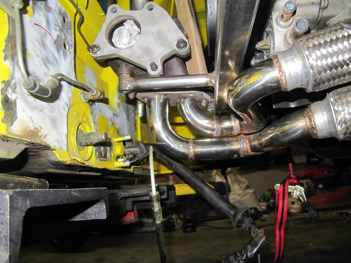

There is a good amount of room in the front of the engine and Britian Smith has already done a good job of showing how it can be utilized

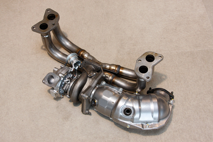

Similar to Britian, but strait from subaru is the new turbo location for the Legacy GT. above is the stock header/turbo set up. however it needs a scavenge pump I believe.
Above is more of a guess but I believe that a rotated set up could work as the turbo "just" clears the rear trunk, but the DP gets in the way (and you need one of those).
The last picture also shows a flipped intake manifold while retaining the AC by the way.
Again with exhaust it is pretty easy to come up with a custom solution that mounts anywhere.
