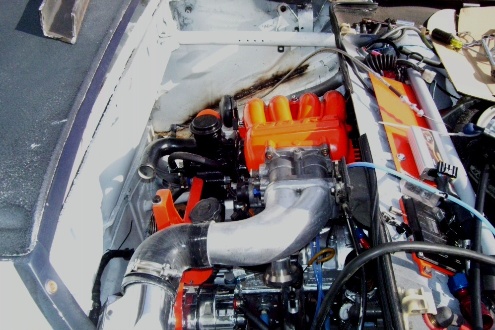

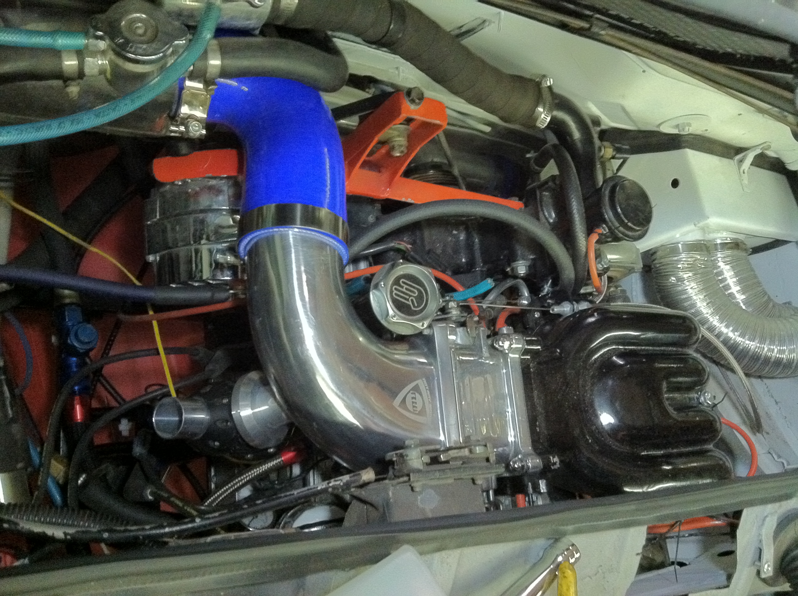

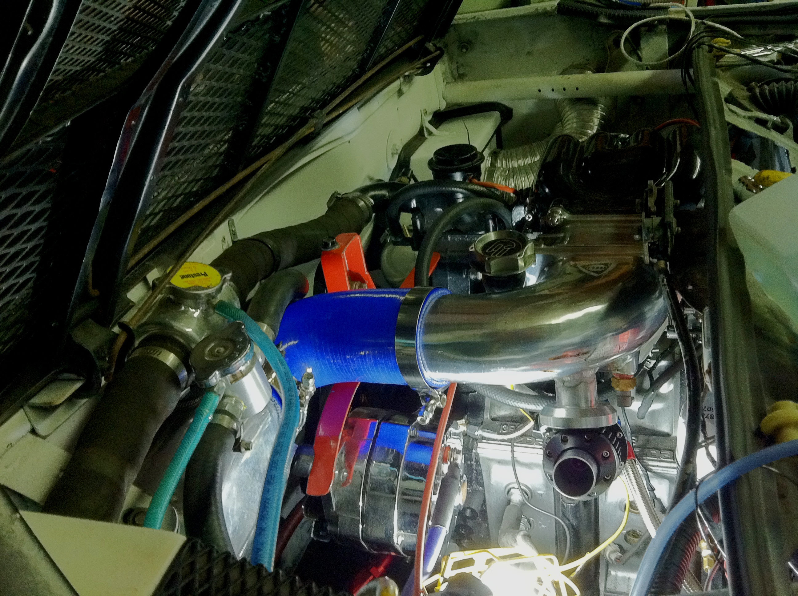

Engine is back together!!! (IMG:style_emoticons/default/piratenanner.gif)
Tomorrow:
Add fluids (water, oil, gear oil, intercooler coolant)
Bleed H2O system
nut and bolt everything
recheck clearance on moving parts
adjust clutch
adjust shift linkage
adjust muffler level to ground
connect ECU, program for larger injectors
crank to prime oil system
install spark plugs
fire up
check for leaks
DRIVE!!!
adjust fuel and spark to new engine configuration
DRIVE!!!
Old manifold for reference...
