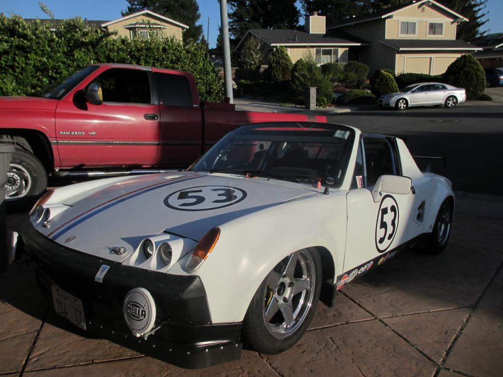

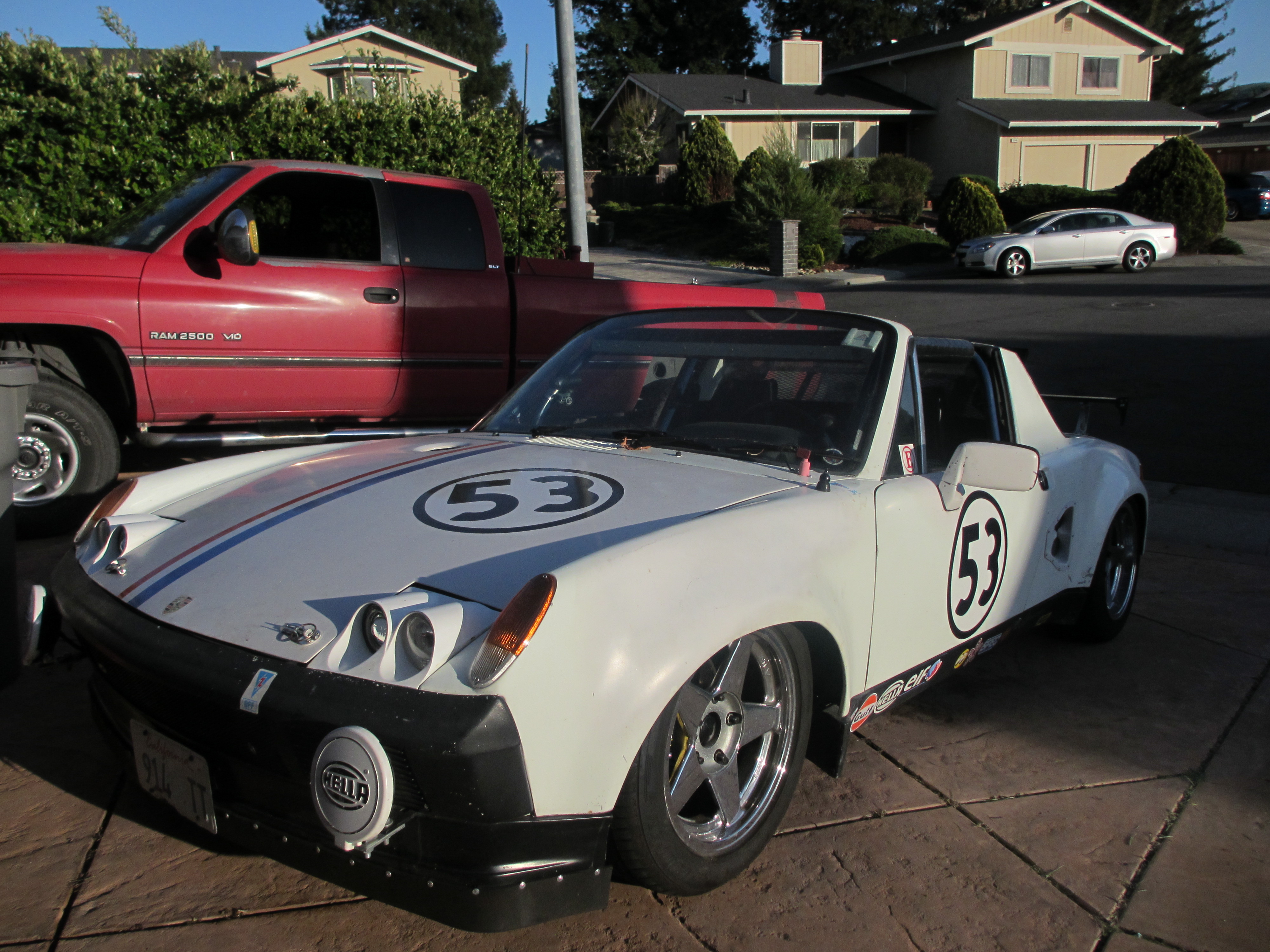

Got it running and out on the road. (IMG:style_emoticons/default/piratenanner.gif)
The tune is close but it will take a few days to dial it back in. The first thing to attack is the transient throttle; kind of jumpy at zero throttle input and cruising.
The new primary injectors are really big so some tweeking is in order.
I'm tired time for a beer! (IMG:style_emoticons/default/beer3.gif)
Starts with no throttle input. (IMG:style_emoticons/default/biggrin.gif) (IMG:style_emoticons/default/driving.gif)
