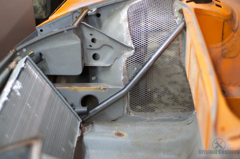

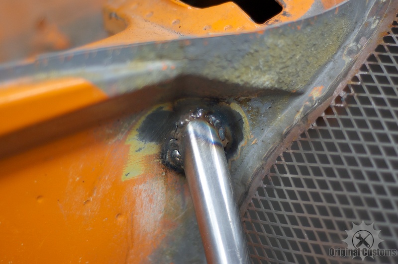

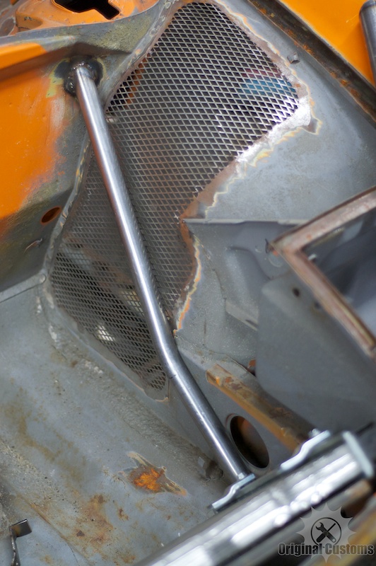

Since someone posted about the fender openings causing stress cracking of the inner fenders, we added these support braces from 1" DOM 0.120" tubing. A single 20° bend keeps them tucked against the wall.
