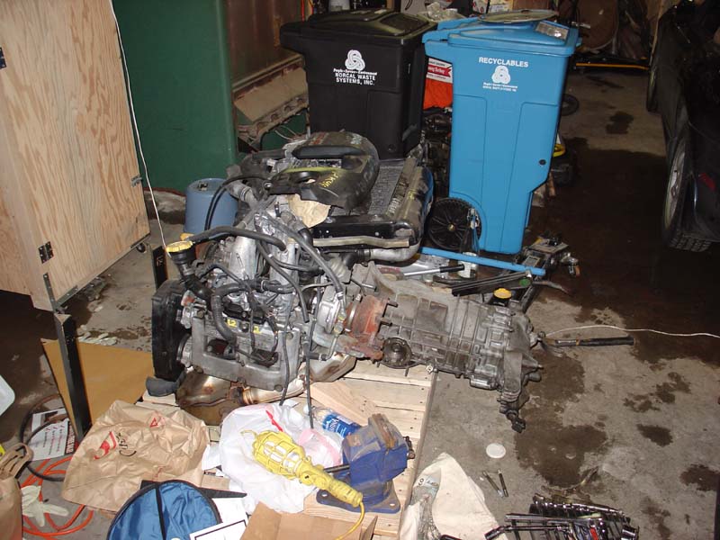

This evening I bolted the dummy transmission to the subaru motor.
Please excuse the mess in my garage.
Here is an aft view.

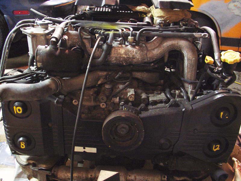

fiid   Count the Cam Shafts!!! (note the sma...   Jan 3 2004, 01:01 AM

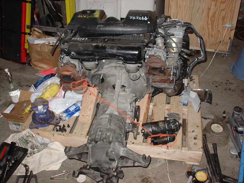

fiid   Now here's the problem. The starter motor rel...   Jan 3 2004, 01:02 AM
fiid   Doh again.   Jan 3 2004, 01:03 AM

fiid   Anyone have a suggestion on how to get around the ...   Jan 3 2004, 01:05 AM

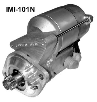

Brad Roberts   Gear reduction starter (189.00) will clear fine. ...   Jan 3 2004, 01:15 AM
fiid   Where do I get one? Doesn't it look great? ...   Jan 3 2004, 01:18 AM
Brad Roberts   The exhaust is going to be really easy and a COMPL...   Jan 3 2004, 01:20 AM
BIGKAT_83   The IMI HI TORQ starters can be indexed to differe...   Jan 3 2004, 01:21 AM
Brad Roberts   I lied. 159.00 Specify BUS tranny when calling. 8...   Jan 3 2004, 01:24 AM
fiid   Hmmm... apparently there is a chevy part that will...   Jan 3 2004, 01:29 AM
fiid   Sometimes - I should just shut up.   Jan 3 2004, 01:30 AM
fiid   > If any of you are looking for a small body gear ...   Jan 3 2004, 01:31 AM
