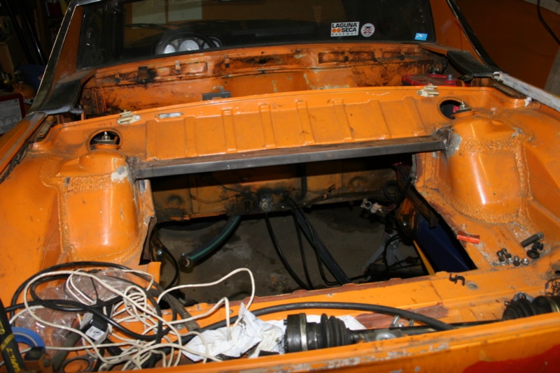

That's it for the front end. Now to work on the back... (IMG:style_emoticons/default/happy11.gif)
From Fiid's previous build thread (the 'mockup' car) there was some interference between the turbo and the rear trunk. Easiest and effective solution? Cut out the rear trunk.
This is the old car. On the new car, we took a different approach.
