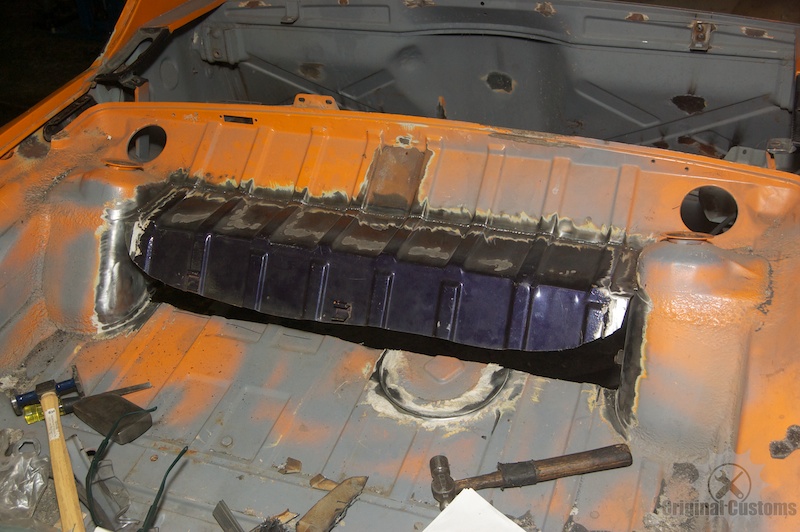

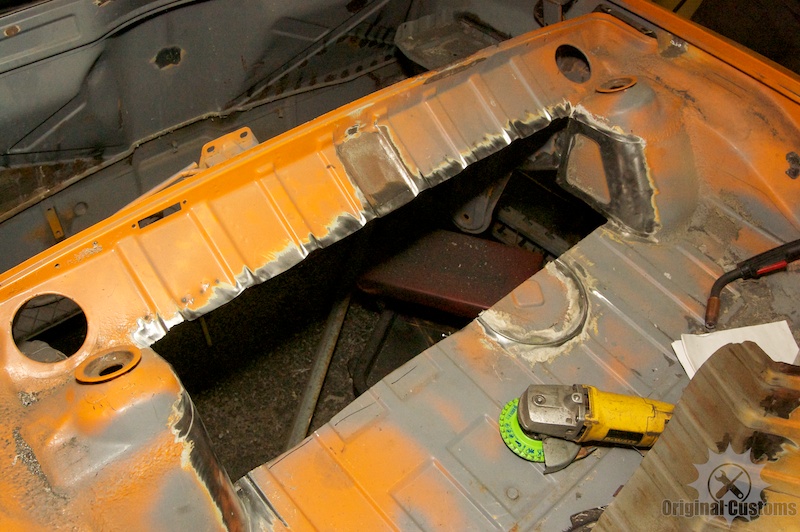

The process started out the same. Cut a big hole in the back.

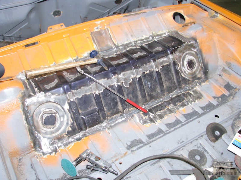

The we pulled a section from a parts car and welded that in. This is the upper-most portion of the area between the shock towers, just reoriented horizontally. This gave a nice smooth curve and maintained all the factory ribbing.
Then a section from the rear trunk floor finished it off. This is the section that rusts out on most cars. The 'knockout' holes don't serve any purpose here, but it lends some originality and interest to this area, so we left them.

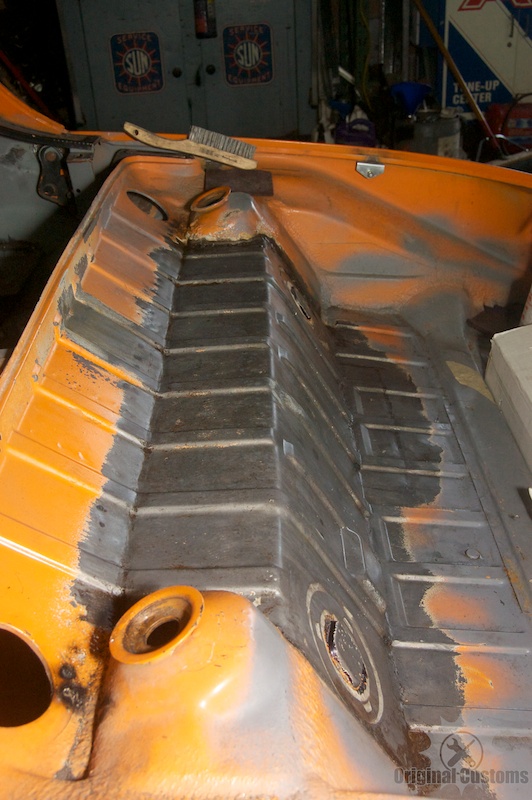

Here is the same area media blasted to bare metal.
