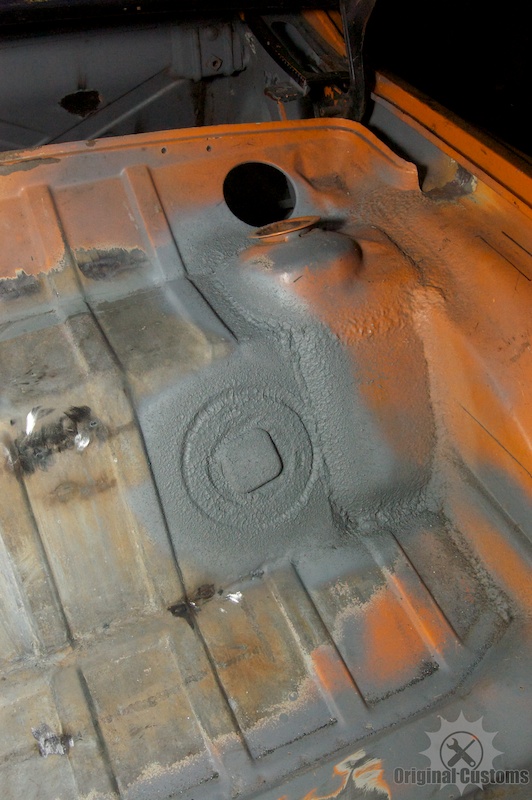

Since the original metal between the shock towers is a boxed section (two layers) I created a second layer below to reinforce this area again and maintain the strength.
Then a quick spritz with my new Wurth adjustable seam sealer gun gives it a factory finish.
