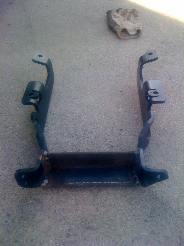

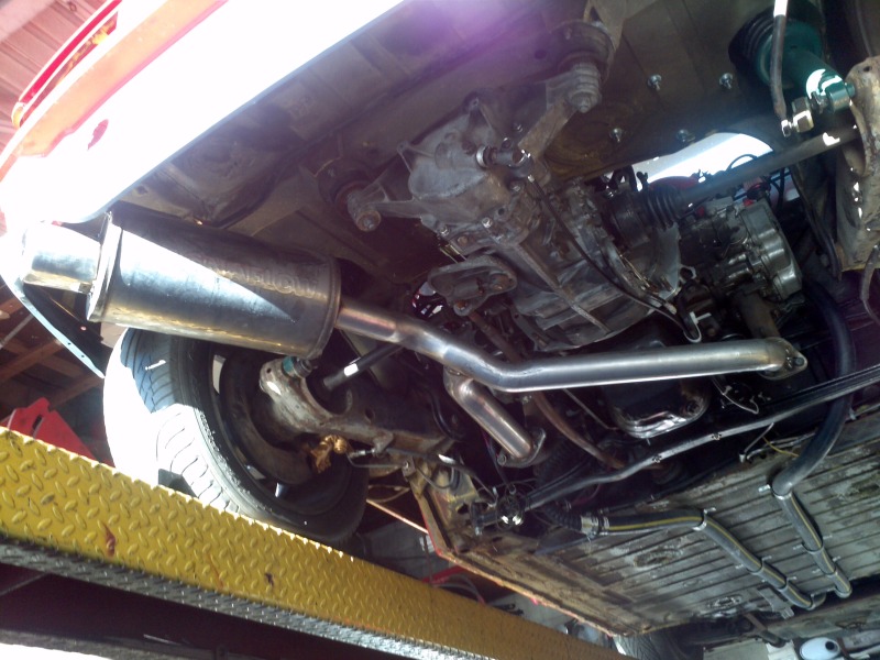

For our project we used the Small car engine mount, we only used the two arms that attached to the motor and then connected them together with some angle iron and then bolted it to the stock engine bar. it required a 1/4" spacer to clear the shift rod hole b/c of the thermostat housing, but then we still had to grind down the top of the shift rod hole for more clearance. We could've just added a thicker spacer, but then the starter would've hit the bottom of the trunk. Here's a picture of our car from underneath and the small car engine mount:
