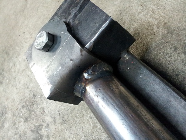

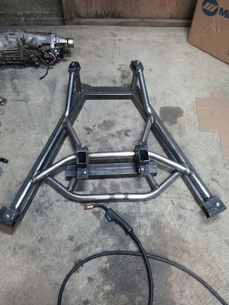

Here are a couple of shots from my first run to get that ugly prototype out of peoples minds and give an example of the weld quality. Im really close, just need to tweak/finsih a couple of things and ill be ready to sell.
