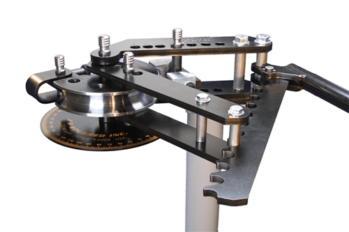

(IMG:http://www.914world.com/bbs2/uploads_offsite/www.jd2.com-419-1334686364.1.jpg)
Buying the mandrels really adds up. I might be able to loan my mandrels out, depending on what projects I have going on.

dakotaewing   Mark - What are you using to bend the DOM ? I need...   Apr 17 2012, 09:42 AM
McMark   http://jd2.com/ http://www.914world.com/bbs2/uplo...   Apr 17 2012, 12:12 PM
