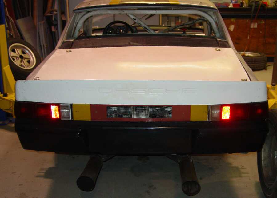

Just finishing up before the race on Sunday
A rundown of the work done:
Removed front and rear hinges and pinned the hood and rear deck lid, this actually removed 10 lbs!
Changed the rear deck lid to a lighter fiberglass lid, removed 6 lbs.
Changed the rear bumper to a lighter unit, removed 4 lbs.
The new rear quarter panels are 6 lbs lighter.
Removed part of the steel quarter panels and lost another 12 lbs
and I lost 20 lbs this winter!
