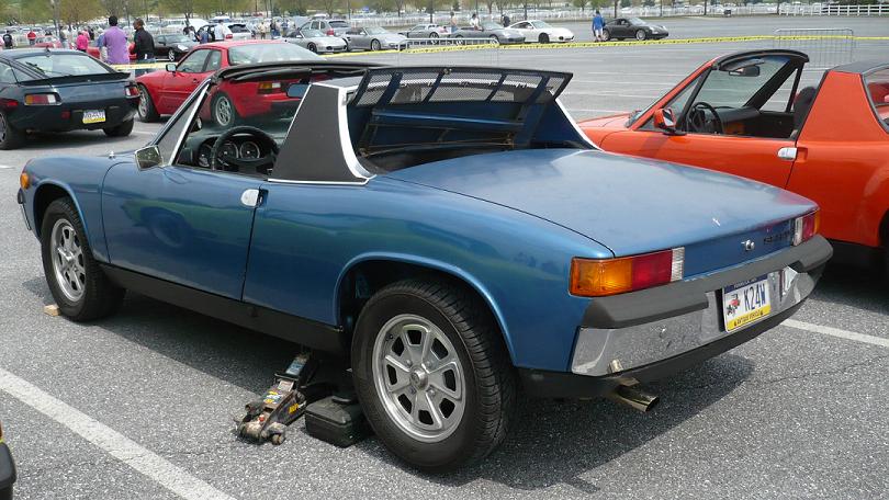

For those of you that are following my emergency thread(s) I will give you the update. Drove to Hershey 30-40 min pushing it a bit, low engine temps and no lugging. I get to the hotel and the car is loud as a #$%er. (IMG:style_emoticons/default/blink.gif)
Running and idling low but not so bad. We drive 5 min to the show and I put the car up and let it cool off. Start adjusting the valves. I had them set at .008 & .006 and I had the loudest clackety engine in Hershey. I adjusted the valves to .006 all the way around because of members reccomendations. When I got to intake on #3...
(IMG:style_emoticons/default/blink.gif) (IMG:style_emoticons/default/barf.gif) (IMG:style_emoticons/default/wacko.gif)
It was soo loose I fit my pinky finger between the swivel foot and the rocker. I am talking (IMG:style_emoticons/default/WTF.gif) is going on here. That was the sound we were all hearing! I adjusted the screw about 8 full turns, almost all the way in, and I got it back to .006. Finished up the last cylinder and fired it up. It was sooooo much smoother and no more noise.
