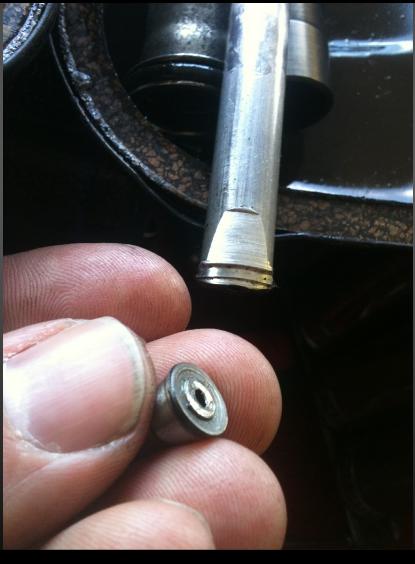

jsayre914   So, as you can see in the pic, the head of the pus...   Apr 25 2012, 01:40 PM
r_towle   Joe, What type of lifter is in there, and I stron...   Apr 25 2012, 03:48 PM
76-914   Joe, I'm too lazy to re-read your build thread...   Apr 25 2012, 05:09 PM
Jake Raby   So.. Here we go. Before I jump into this I want to...   Apr 25 2012, 05:26 PM
