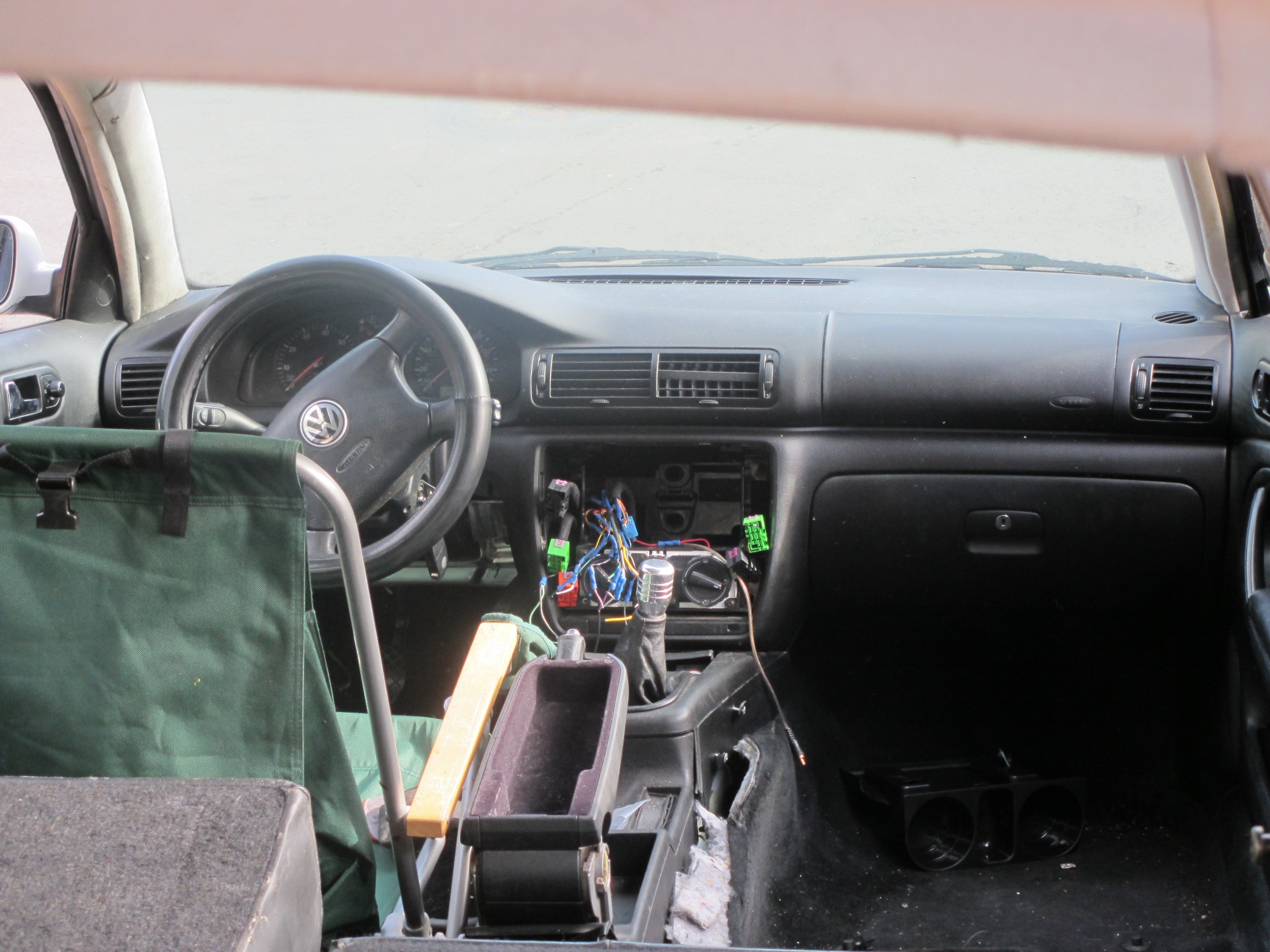

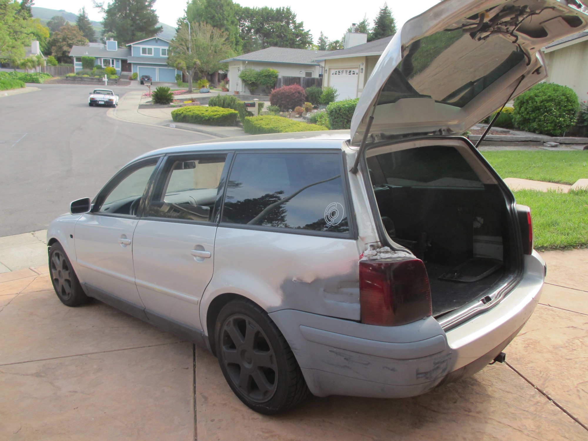

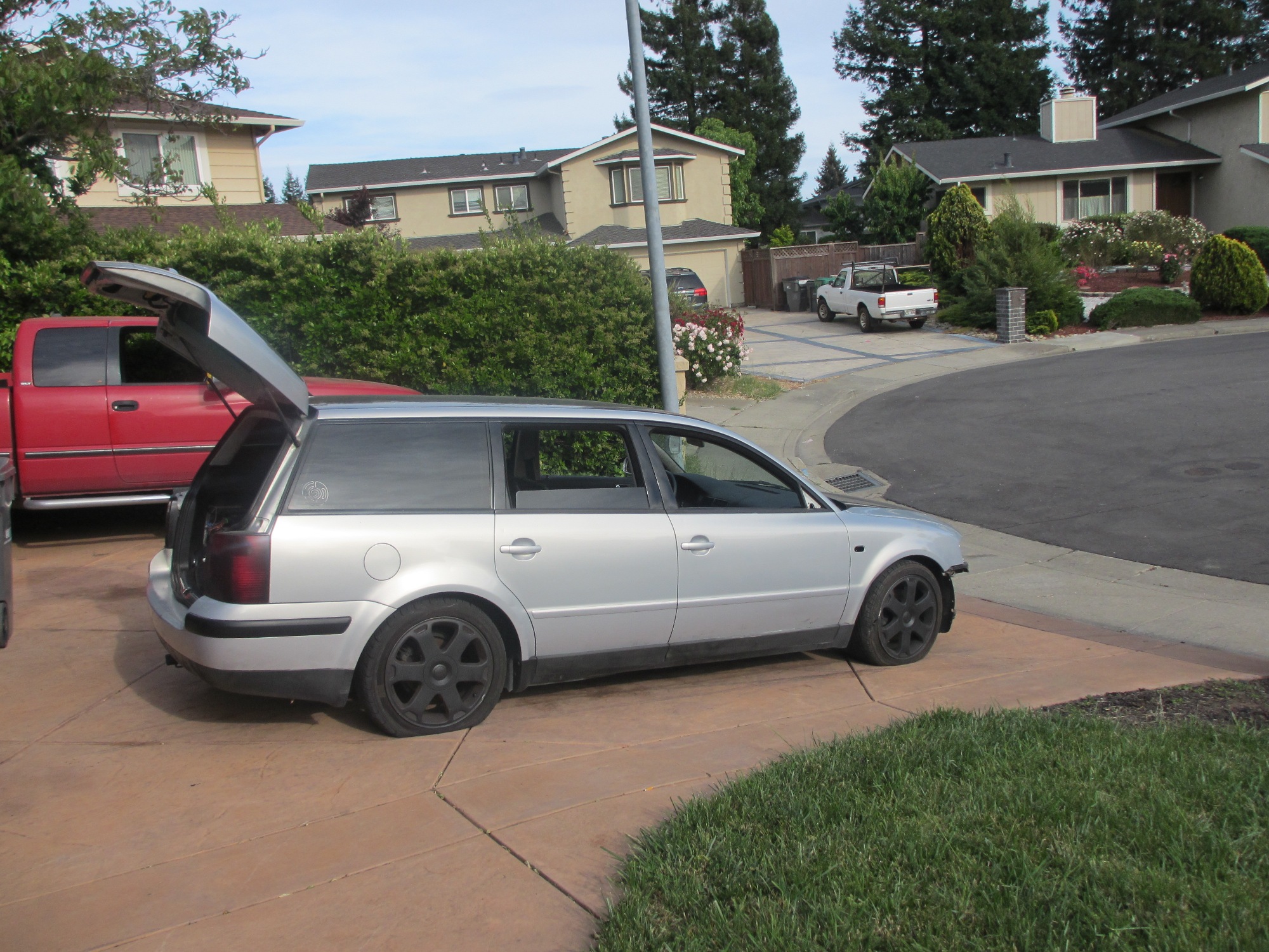

Look what followed me home today. Can you say donor car???

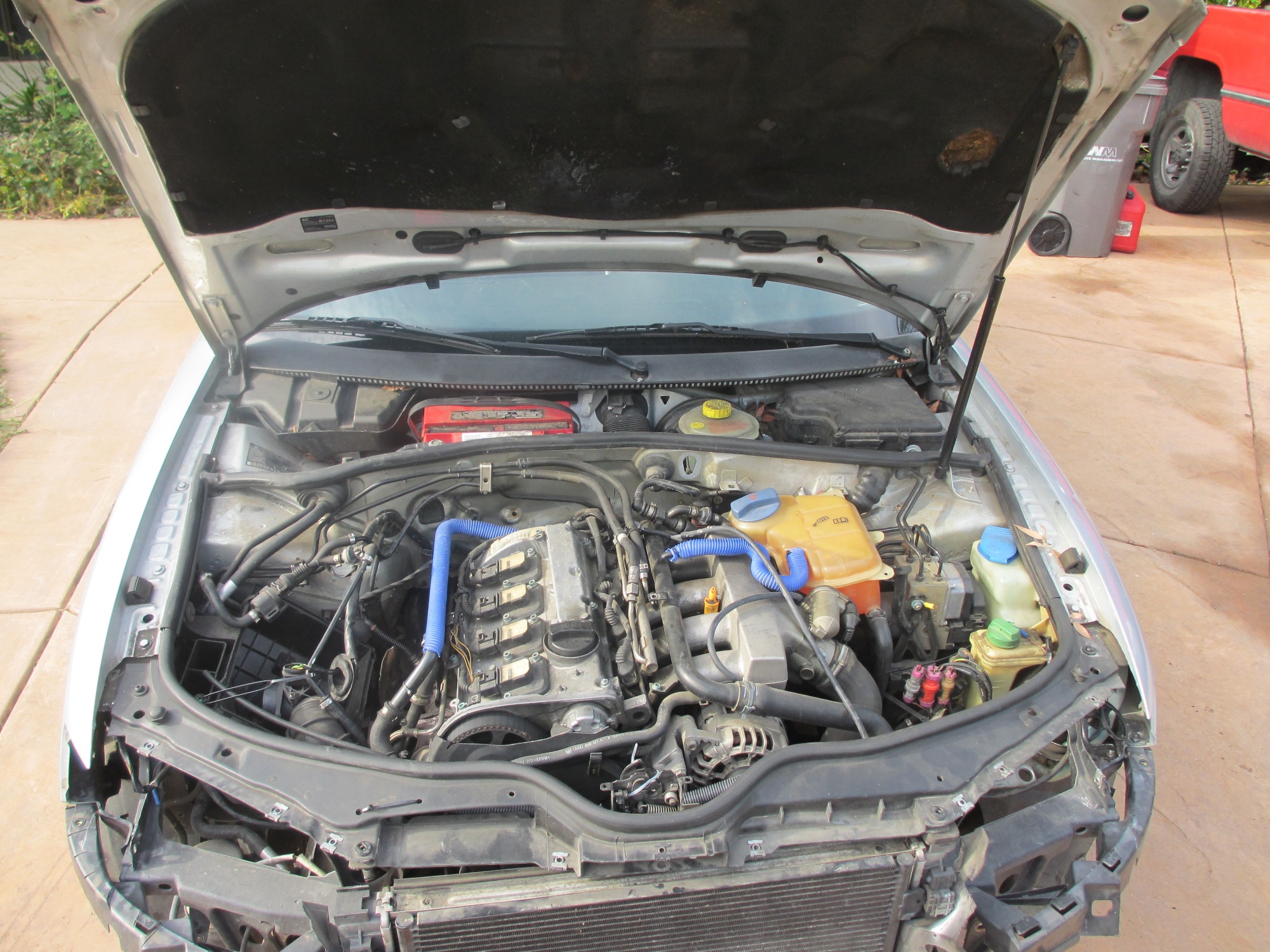

2000 VW Passat, 1.8 Turbo, 5 Speed, Chipped ECU, SPEC Stage 3 Clutch, bunch more goodies. The guy hit a 1 foot by 3 foot piece of concrete on the freeway at 1am. The right front wheel took most of the blow along with the rocker panel and rear wheel. The bumper and intercooler were also damaged. Engine runs good and is driveable, but the two wheels and tires are wasted! The guy is out of work and sold it to me cheap. Real cheap!!! Some of the interior was sold prior to my purchase. Hence the lawn chair drivers seat.
The Plan:
strip apart the harness wire by wire and get rid of what I don't need. No biggie, been an electrician for over 20 years. Decide if I want to keep gauges, info display, etc...
Install the engine/tranny package. Get it running as is but with my air/water intercooler. Then decide if any other mods are warranted. The engine should be good for 200hp as is.
Sell off current engine, ECU, 901, etc... I sold my first blown rotary for $500 yesterday. Who would have thought there was a market for blown engines??? (IMG:style_emoticons/default/WTF.gif)
This time I am using the factory VW ECU and components. No custom programming. I may get it tuned once complete and see if there is any more easy hp inside. At least I don't have to invent the wheel on this one.
The intake and exhaust on this engine are on the same sides as my current setup. Nice! This is a throttle by wire so the pedal will have to swap too. The clutch master cylinder also.
Other than some interior bits, this is a complete car. I should have most everything to pull this off.
