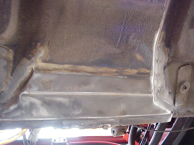

The pan isn't all bad though. Here's the center section where it meets the firewall.
