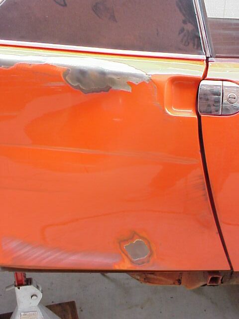

post Apr 19 2003, 06:14 PM
Mike Ginter
Posts: 16,111
Joined: 26-December 02
From: Denver CO.
Member No.: 20
The damaged right rear quarter had some bondo in it.
