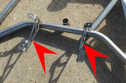

any concerns with the amount of cantilever or thickness of steel used for engine brackets. i ask because the the small car mount appears much thicker.
IM101
post May 15 2012, 12:13 PM
Posts: 264
Joined: 9-November 10
From: Boise Idaho
Member No.: 12,367
QUOTE(jimkelly @ May 15 2012, 10:18 AM) *
The pictured cradle is a prototype and the mounts have since gone through several revisions, they are now 1/4" with gussets to give lateral support and spread the load. I would bet the reason the small car mount is so thick is that their "cradle" and engine mount is the same piece that spans around 18" unsupported on one side. To make that span possible they had beef it up 3/8" thick.
Just to update, I’m still in process and hit a small snag. The original prototype ended up being a little too low, leaving the header and oil pan vulnerable. Basically it’s looking like to use a Subaru transmission will require some cutting to the rear trunk, not massive amount but a little. The overall height of the Subaru drive train is just too much to fit seamlessly. it could probably be done, it would just require a dry sump oiling set up and a really short header, which increases the cost quite a bit.
How I have it set up now the stock pan/header is tucked up enough to not be an issue, while still maintaining the ability of an NA Subaru>901 to be installed no cuts necessary, if you add a stock location turbo, rear trunk cutting will be required. If a Subaru transmission is chosen cutting of the rear trunk, to clear the slave cylinder and the starter, will be required.
Hopefully that solution will be acceptable; it is the best I could think of within the parameter of making it as universal and as easy to install as possible.
