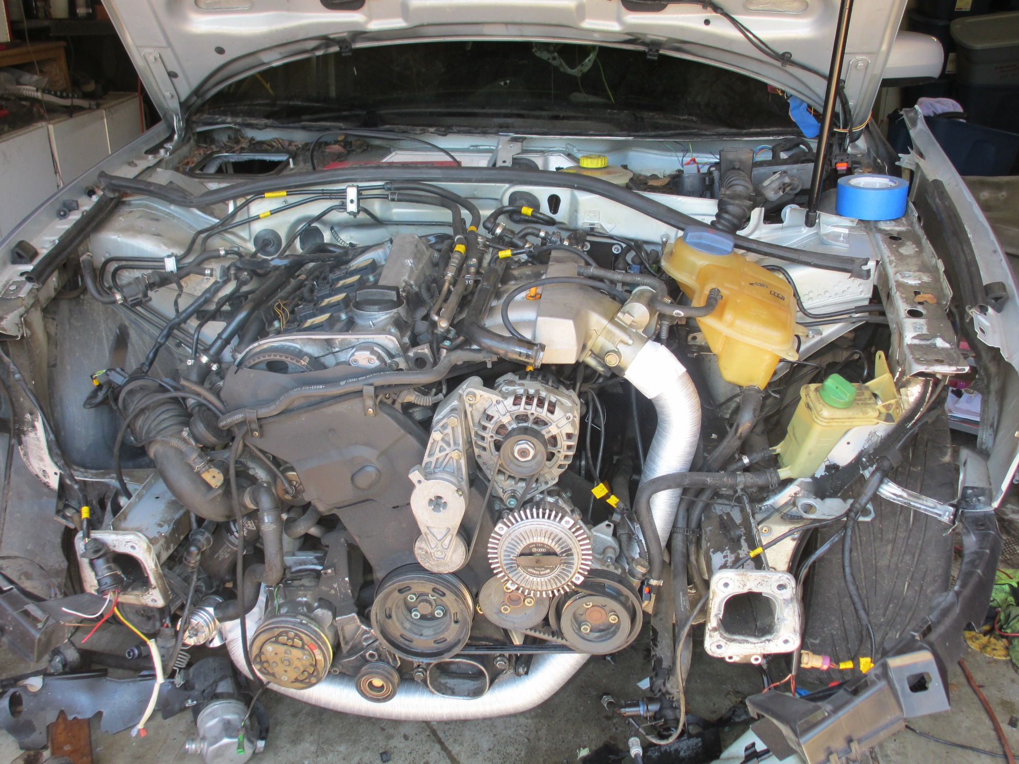

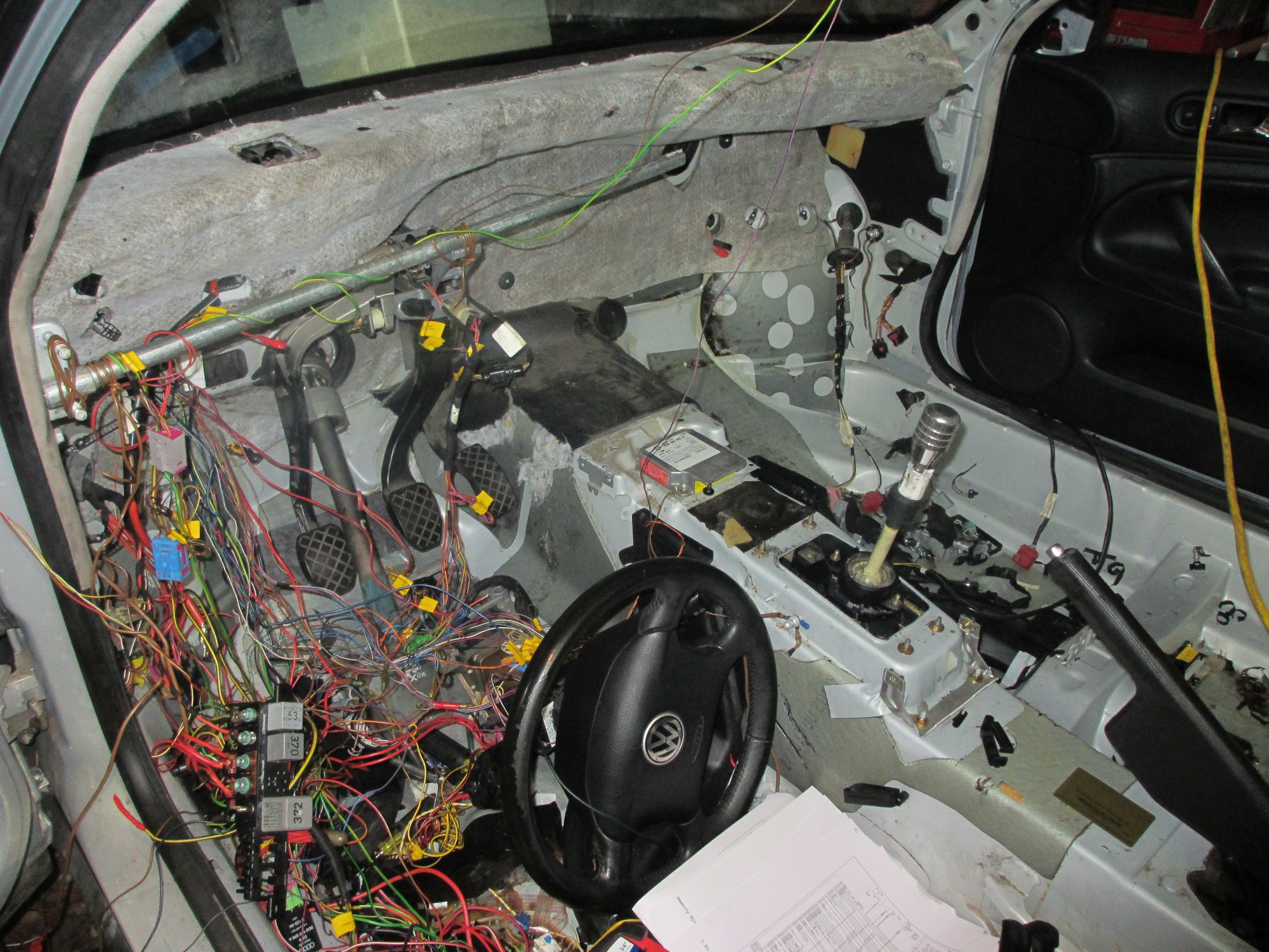

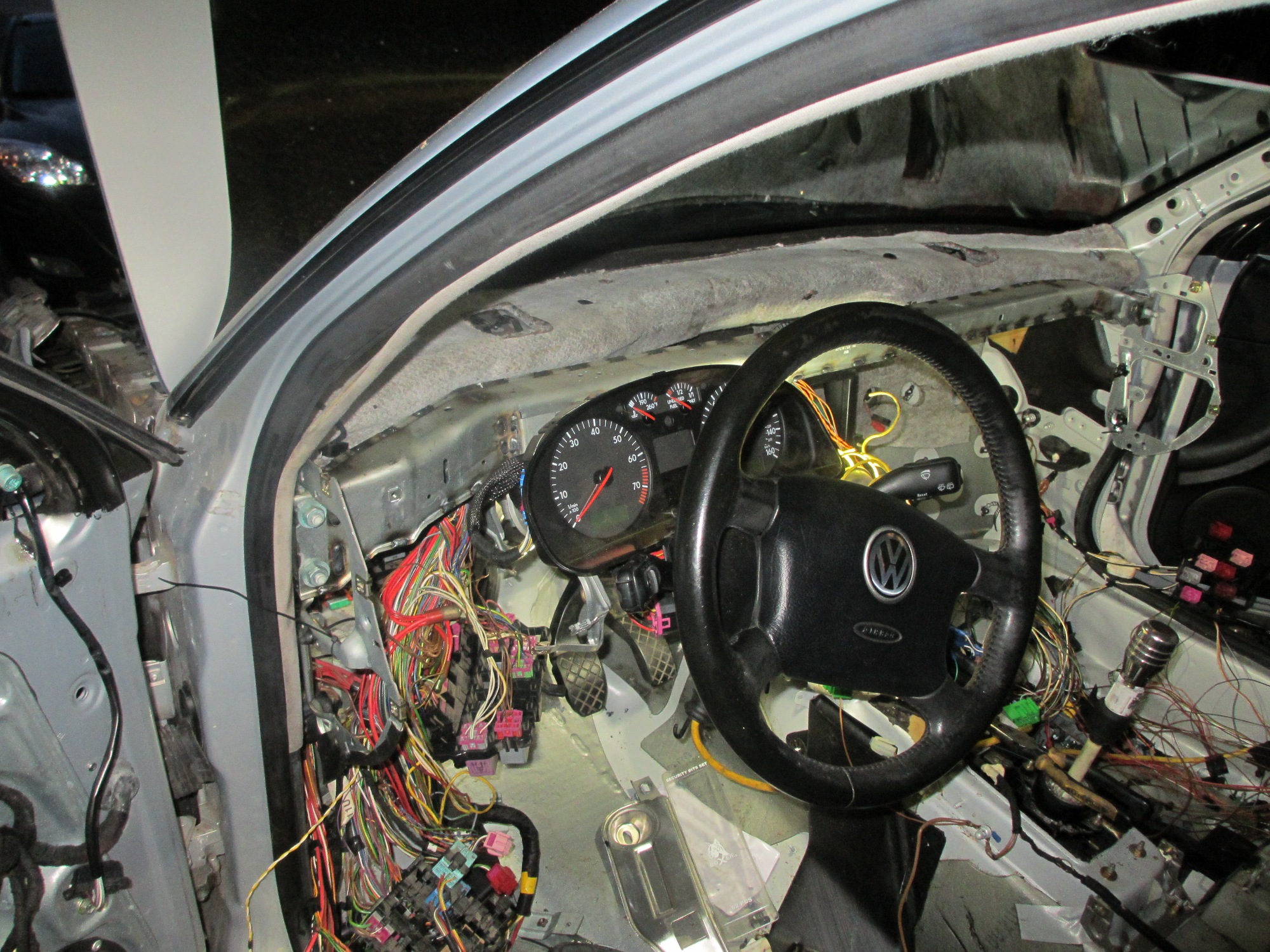

Been busy on the donor car. Stripped the wiring out wire by wire. Once you get the interior out there are a shit load of wires to pull. I started with the radio and speaker/amp harnesses. Easy to spot and took out a lot of wires. Switched to the tail lights. followed those to the front and removed. Then air bag, abs, AC, interior lights, wipers. I was left with some relays, fuse panels and misc extra wiring. I then pulled out a schematic and got it down to the EFI, Steering column and gauge cluster. It still runs!!! (IMG:style_emoticons/default/smile.gif) Its ready to pull out compleatly. Should be an easy transfer. I'm keeping the gauge cluster. It needs a little trimming to fit the stock dash, not too hard. Then I get to keep most of the idiot lights and dash comoputer that says "STOP Low Oil Pressure". Turn signal and high beam lights should work too. I might even be able to get the traction control to work if I fab sensors to the wheels.
Hers a couple pics of the stripped dash and wiring...
Here's a pick of my getto intake tube, just used to verify the car was running throughout the operation...
