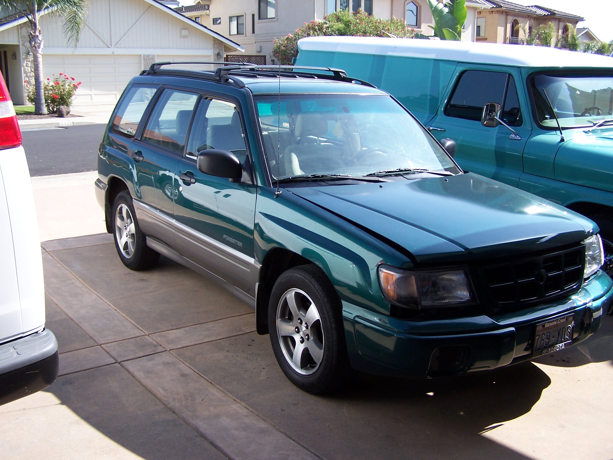

(IMG:style_emoticons/default/blink.gif)
EJ25D with 5 speed
Too much time on CL while the site was down.

kg6dxn   Look what followed me home today. Can you say dono...   May 2 2012, 11:12 PM
Andyrew   YEEEAHH! You wont find any more HP than what...   May 2 2012, 11:50 PM
jeeperjohn56   Hey Mike, The old lady next door is going to have ...   May 15 2012, 05:03 AM
kg6dxn   It's in the garage right now. 914, still under...   May 15 2012, 10:55 AM
oldschool   It's in the garage right now. 914, still unde...   May 15 2012, 11:45 AM
Andyrew   Boxter trani, Well that blows the budget right out...   May 15 2012, 11:28 AM
kg6dxn   Boxter trani, Well that blows the budget right ou...   May 15 2012, 04:05 PM
Rand   Psst. Hey. Ecotec 1000hp, smaller displacement. Re...   May 15 2012, 02:20 PM
kg6dxn   Psst. Hey. Ecotec 1000hp, smaller displacement. R...   May 15 2012, 03:28 PM
Rand   Psst. Hey. Ecotec 1000hp, smaller displacement. ...   May 15 2012, 03:34 PM
Lennies914   :blink: :D EJ25D with 5 speed Too much ...   May 15 2012, 05:46 PM
kg6dxn   EJ25D with 5 speed Too much time on CL while t...   May 15 2012, 05:57 PM
Lennies914   EJ25D with 5 speed Too much time on CL while ...   May 15 2012, 06:01 PM
kg6dxn   This is going to be a throttle by wire install. In...   May 15 2012, 05:52 PM
Lennies914   Mike, Have you considered using the pedal assy. fr...   May 15 2012, 05:58 PM
kg6dxn   Mike, Have you considered using the pedal assy. f...   May 15 2012, 06:08 PM
Lennies914   I'm thinking of cutting out the entire front f...   May 15 2012, 06:46 PM
