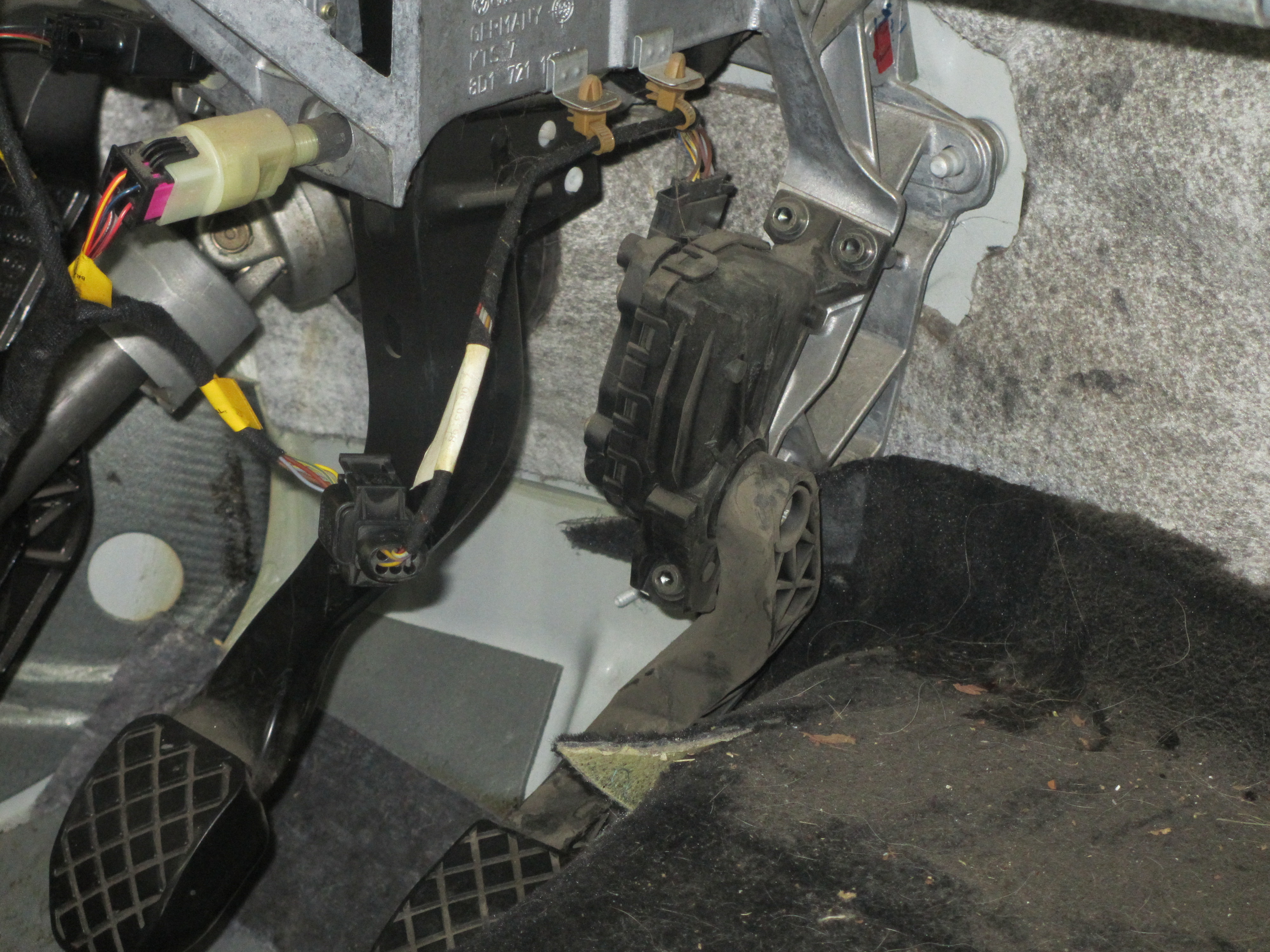

This is going to be a throttle by wire install. In this pic of the pedal, there are only 3 bolts holding it to the bracket. Should be an easy transplant, 6 wires to run to the pedal area. I will have to fab a hydraulic clutch. Looks like I have donor parts, but I might go with a Wilwood master cylinder.

kg6dxn   This is going to be a throttle by wire install. In...   May 15 2012, 05:52 PM
Lennies914   Mike, Have you considered using the pedal assy. fr...   May 15 2012, 05:58 PM
kg6dxn   Mike, Have you considered using the pedal assy. f...   May 15 2012, 06:08 PM
Lennies914   I'm thinking of cutting out the entire front f...   May 15 2012, 06:46 PM
