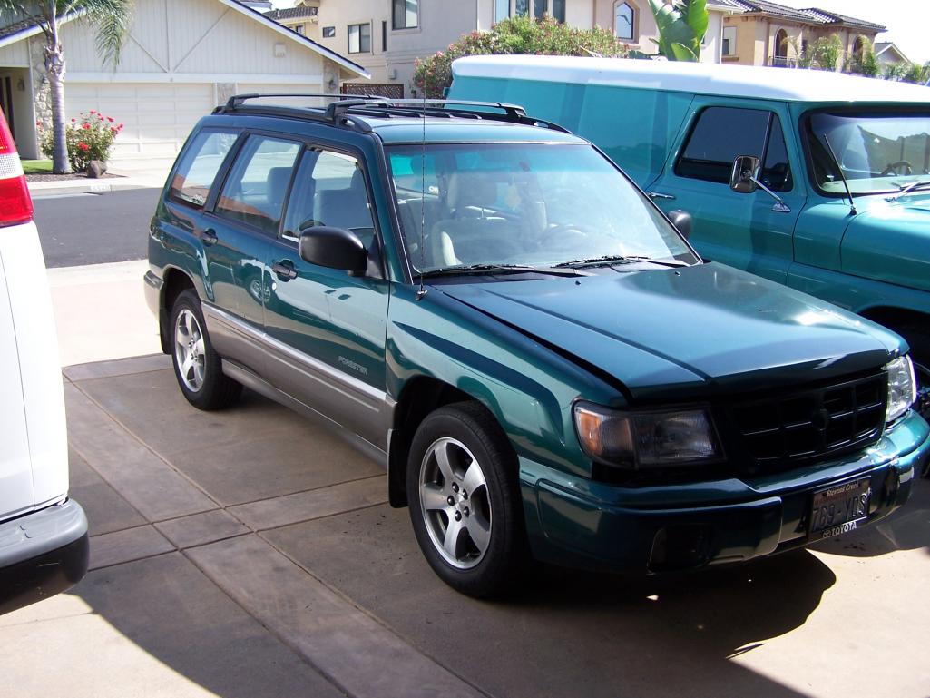

EJ25D with 5 speed
Too much time on CL while the site was down.

QUOTE(Lennies914 @ May 15 2012, 04:46 PM) *
EJ25D with 5 speed
I know what you mean.
That green 914 from Idaho motivated the change. I would never driven the rotary that far. It makes a better race motor than a street motor.
I'll see if I can drive it to Moab one of these days. (IMG:style_emoticons/default/smile.gif)
BTW, Nice score! Subie... doobie... doo...
