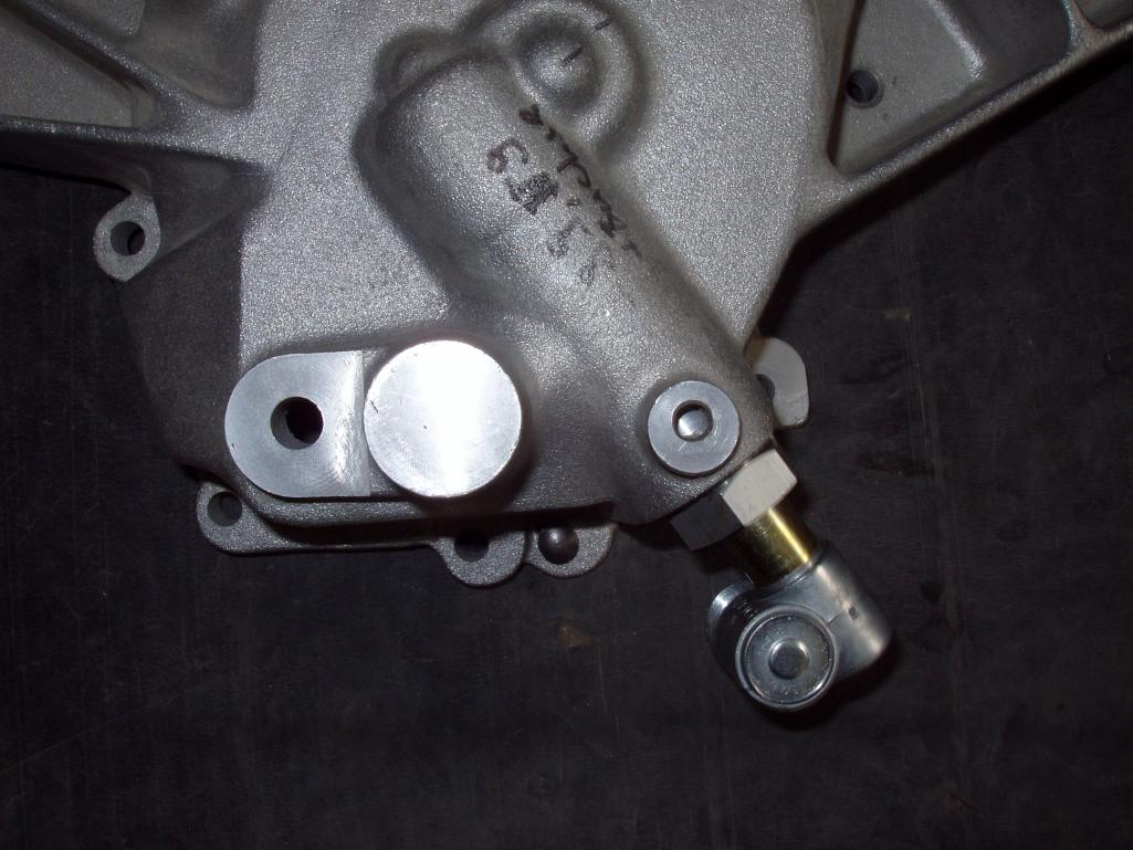

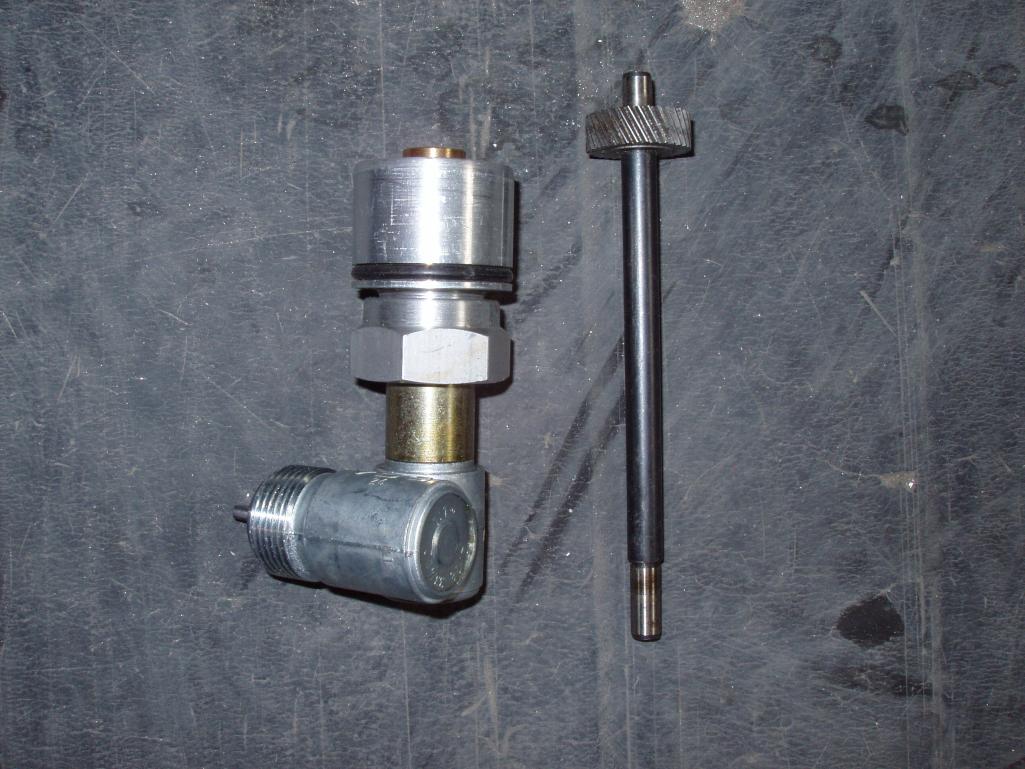

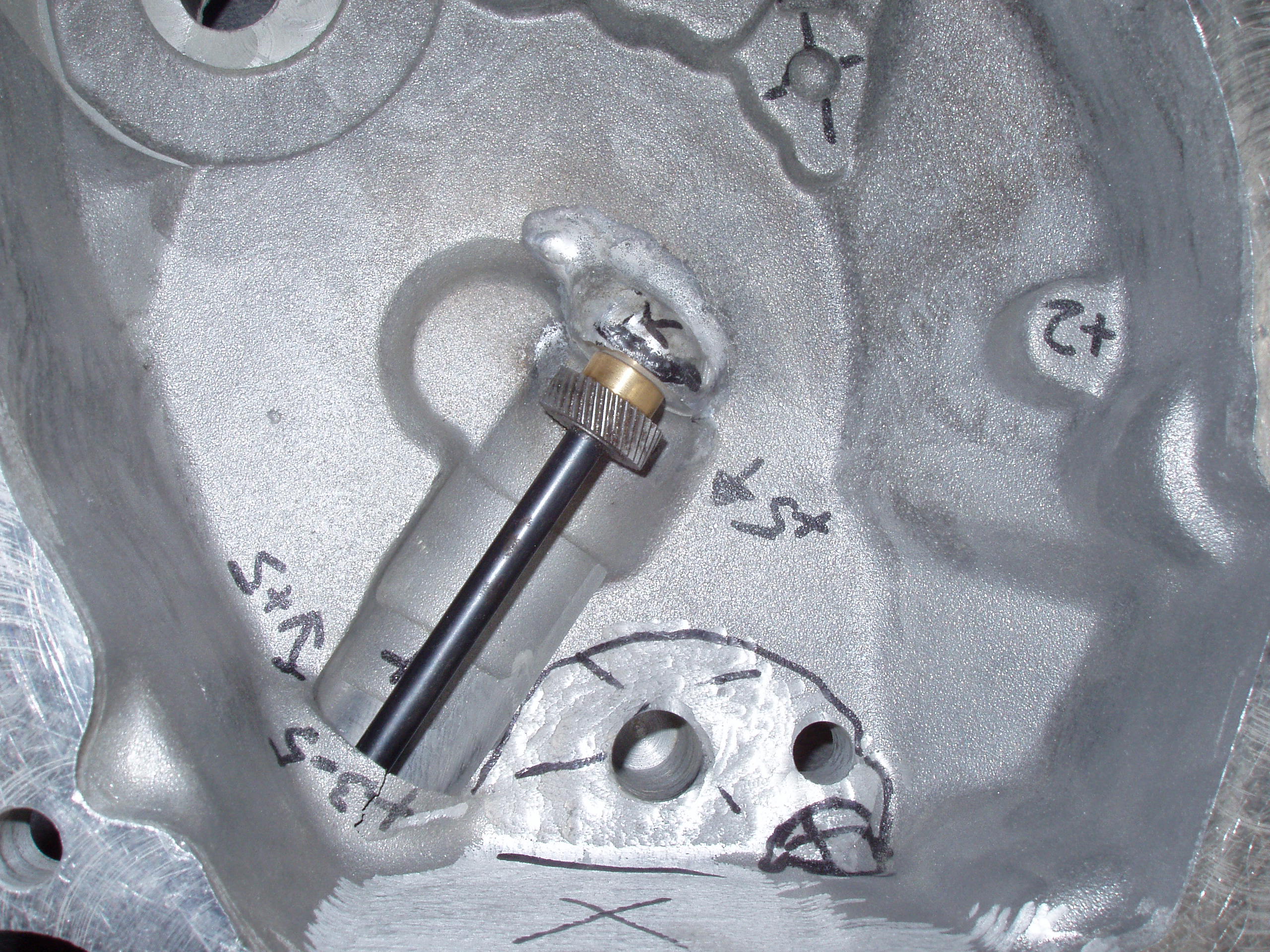

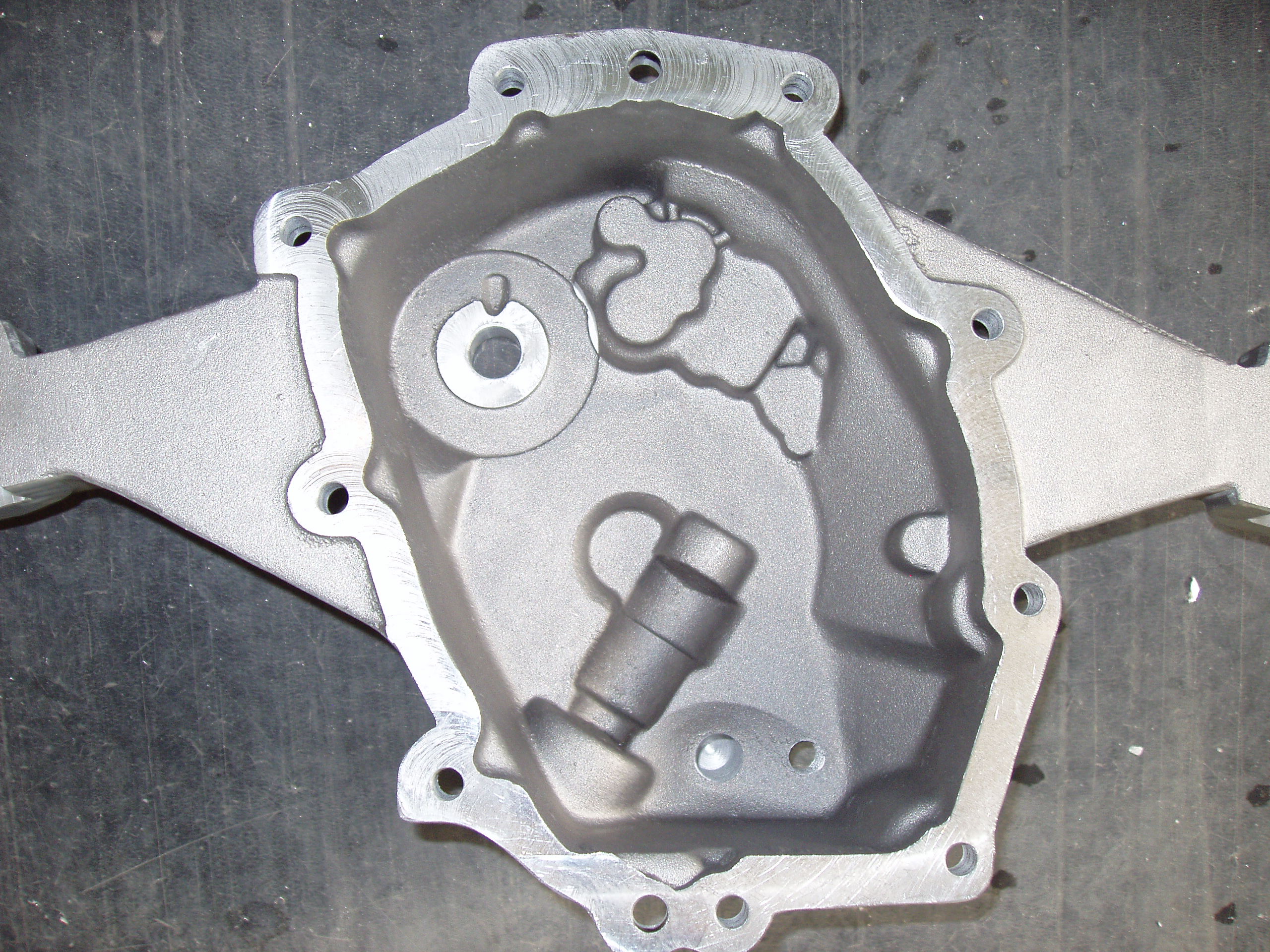

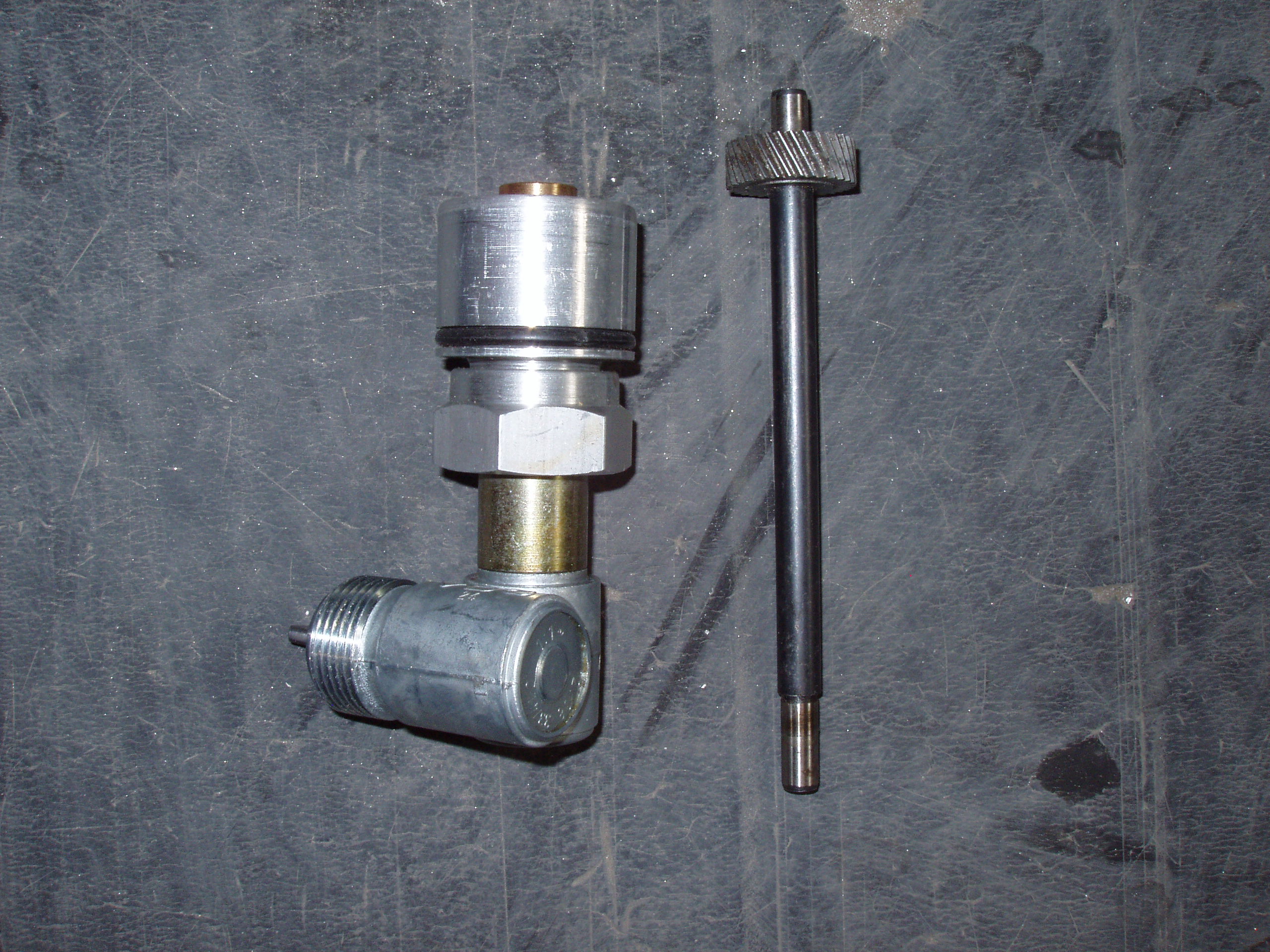

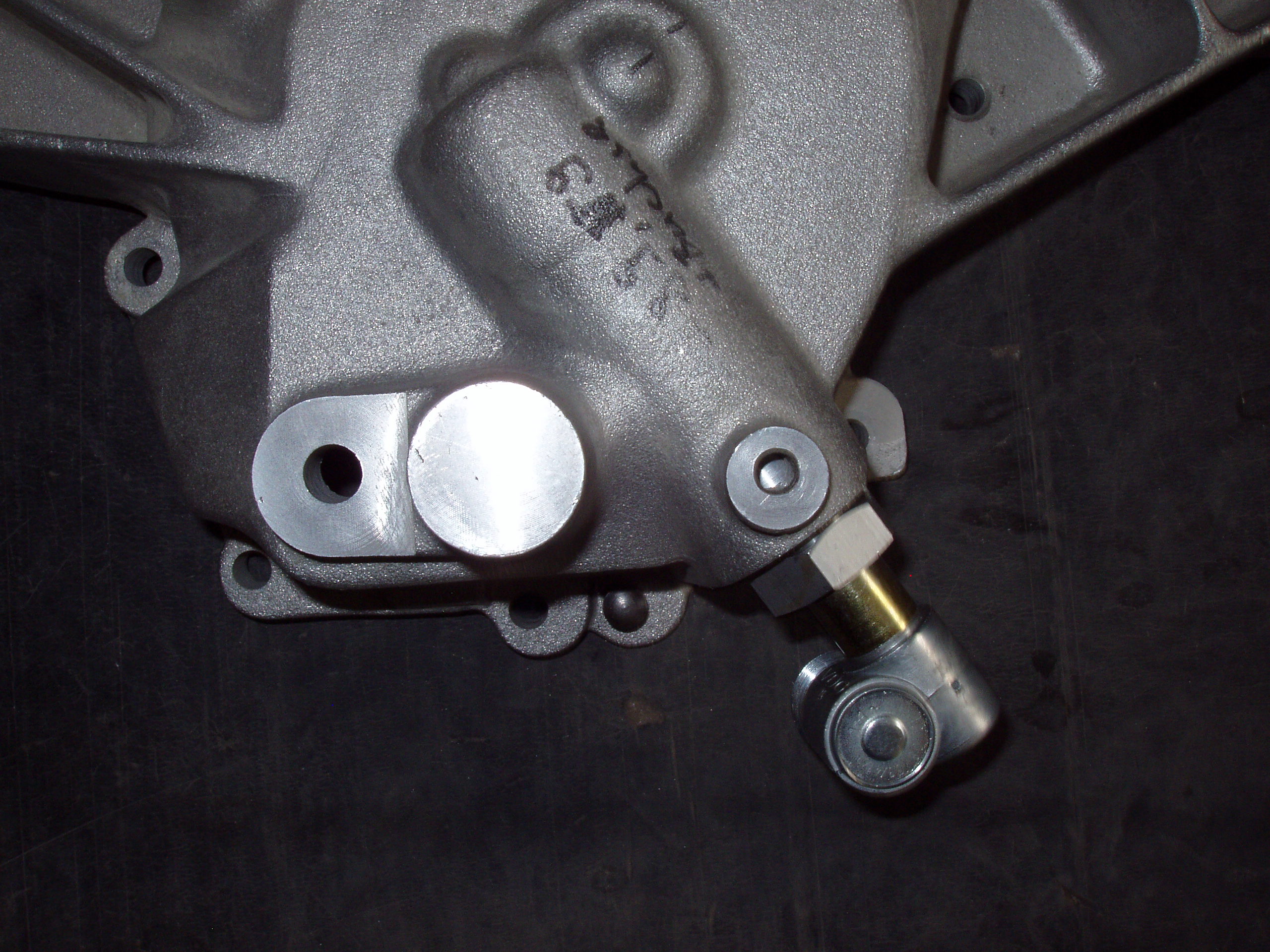

Hi,
some pictures of the new nosecones with the upgrade for the mechanical speedo drive. Currently have a long lasting order for industry on my milling centre, so that parts have not been finnished milling for the speedo drive. At the moment they can already be mounted to a electronic speedo gearbox. Hope that I can do the final milling by end of next week. You can see our prototype where we welded the position for the bearing of the speedo shaft. The other picture shows that the mould was adjusted in some places, especially to hold the speedo-parts. Also see the mechanical parts for the speedo drive that we already prepared (only minor adjustment have to be done still). Will keep you informed and will give further info as soon as parts are done.
Martin Bott
