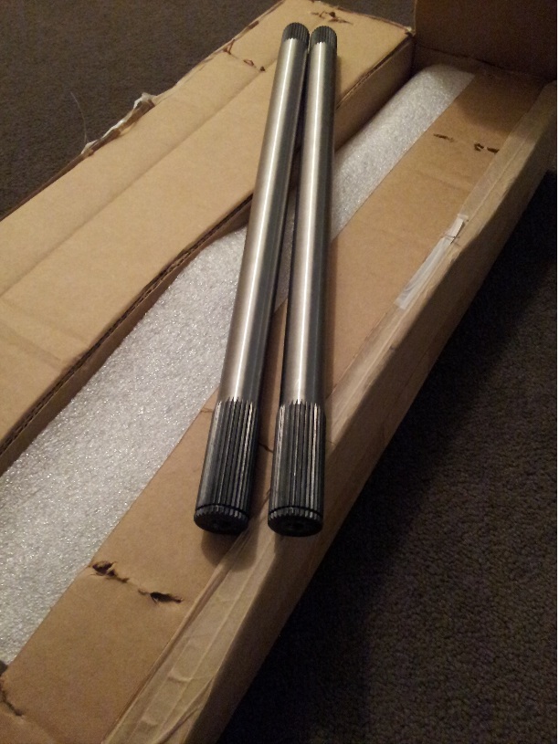

(IMG:style_emoticons/default/piratenanner.gif) Look what just showed up! Super amped to finally get these test axles in from Sway-A-Way, they are Subaru DOJ (inner CV) and 914 or 944 outer, 4340 chromoly, and the signature Sway-A-Way free floating style. All I need to do now is a test fit to make sure they are correct length and I’ll be ready to sell them.
(IMG:http://www.914world.com/bbs2/uploads_offsite/i1199.photobucket.com-12367-1337275744.1.jpg)
(fresh out of the box)
