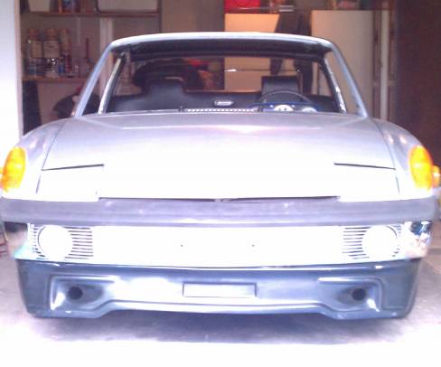

post May 21 2012, 11:28 AM
May your glass be smaller so it's always FULL!
Posts: 1,081
Joined: 10-June 08
From: Seattle
Member No.: 9,160
Spoiler mounted to give it a completed look and feel. Not comitted to using it. Front valence is still getting finish work.
SEE POST #109: I'm going to use the original metal valence. NOT this ----> Attached Image
