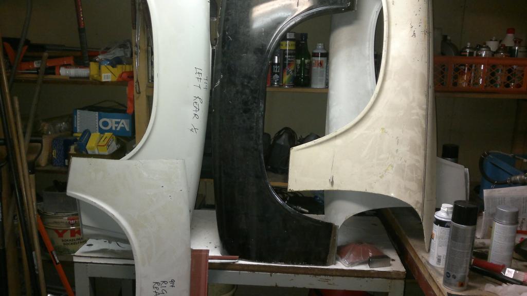

Enough fenders?

OmaPossu   Just got all four fenders from Restoration Design,...   May 16 2012, 06:08 AM

OmaPossu   Enough fenders?   May 22 2012, 12:38 PM
